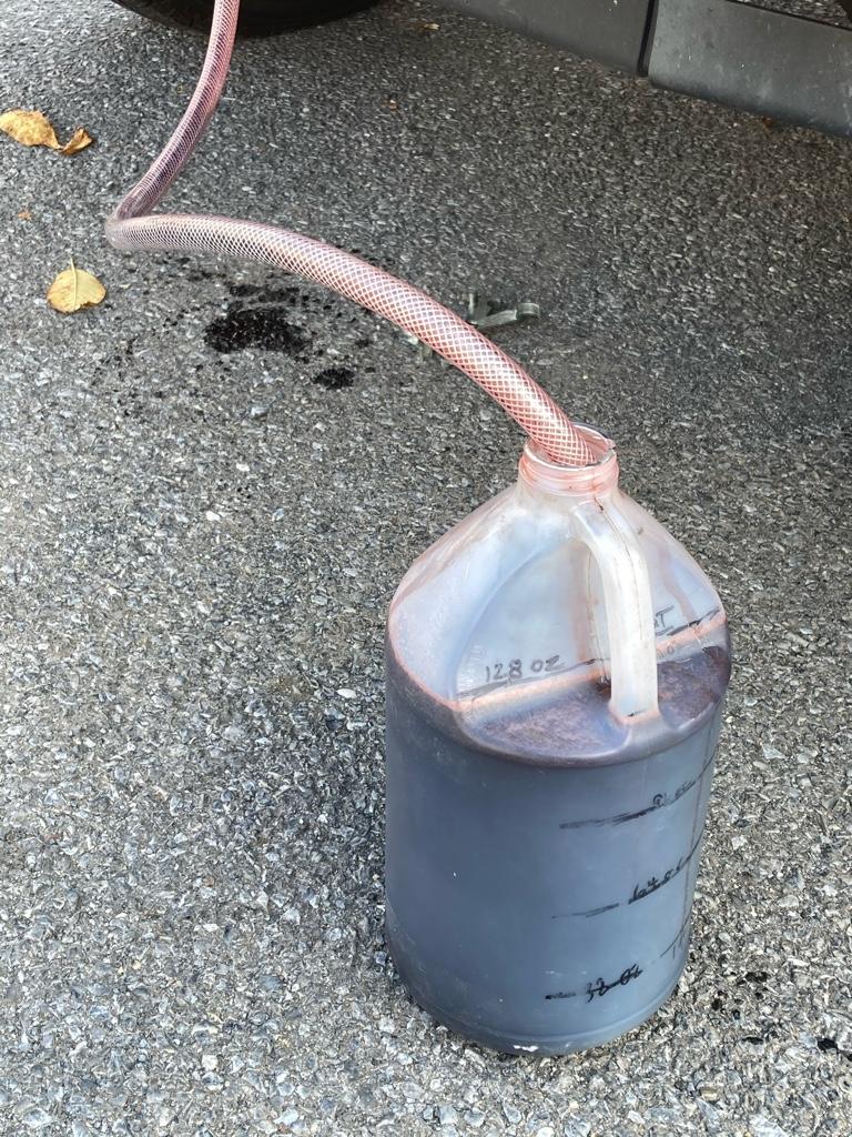

Buy 16qts of fluid of choice, pull return line at the quick connect and stick it in a washer fluid jug. Start vehicle, cycle thru the gears as it pumps out 4qts, refill, repeat until running out of new fluid. For extra piece of mind and cleaning, dump a can of BG Quick Clean (or similar) into the trans and high idle up to temp, cycling through the gears every 30 seconds or so, prior to disconnect and pumping out. It’ll help dissolve any gunk in the valve body passages and trans cooler.
3/8” ID clear hose fits over the return line. You can make the washer fluid jug into a graduated container by measuring out every 32oz with a mason jar. You will need a quick disconnect tool for the return line fitting also

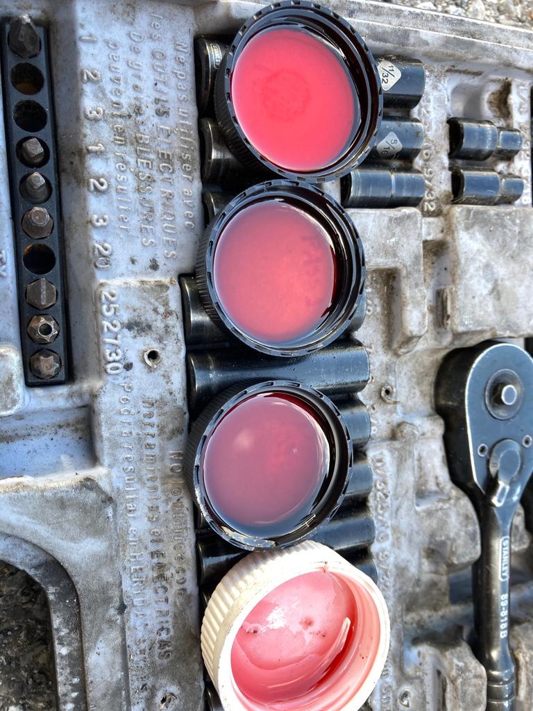

I went with BG full synthetic ATF and dumped a bottle of BG ATC in afterwards. Lost about 2-3mpg afterwards, YMMV. I’ll be doing it again when i install a Hayden 679 cooler, dropping the pan and installing new solenoids and a new filter, and will to Amsoil next time. Not thrilled that the BG ATC turned my bright red brand new fluid brown after putting it in. Top to bottom fluid condition (fresh fluid from bottle on top, white cap is final pass prior to ATC being poured in)
