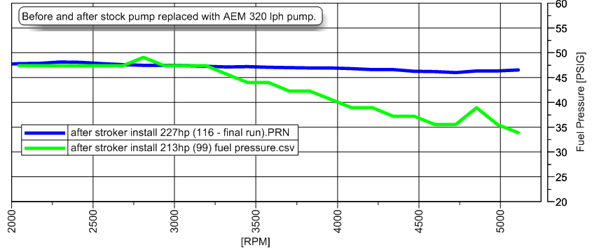

When I did the swap I eliminated the stock fuel filter in favor of a corvette fuel filter/regulator in prep for an LS swap. But with the stock filter/regulator, I don't see why this pump wouldn't work just fine.
Also I drove around for quite a while with this setup and place with the stock 4.0 and worked rather well, it just ran a little rich when the ecu was in open loop because the corvette fuel pressure regulator runs at a higher pressure.
I didn't comment on the thread but I used the info when I did my swap.
I run this pump with a new stock regulator setup. Works great.
Thanks for the writeup Mark! I just swapped this pump into my 2000 XJ because of fuel delivery problems after my stroker build. It looks exactly like the stock pump and is an easy swap. One thing I found out in looking for a pump for my XJ is that the Walbro pump WAL-GSS342G3-766 that is said on some sites to be a 255lph replacement for 1995-2001 XJ's is not. The body of the pump is longer as well as the bottom config is different than the stock 97+ pump. The AEM pump is the one to go with. I recommend that anyone who is doing a stroker build look into this swap, since our stock pumps have a problem keeping up on the high end, with bigger injectors.
