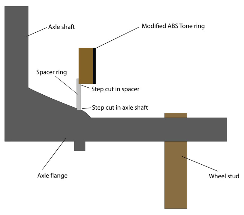

Could you make a profile view drawing and post it here, showing the shape of the machined tone ring and the adapter for me to understand better?
Thx
Threw this together for you in 5 minutes:
I am just curious of the parts list you actually used. I am gathering that you got the abs sensor and tone ring off the d35 and retrofitted to the c8.25 and used the d35 discs off a zj?
I just picked up another xj with a d35 and abs and I want to swap in a 8.25, but don't want to lose my abs as its my daily driver.
