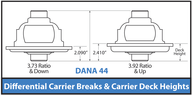

Ok what is a "carrier break" / 2.47 down etc in reference of?
It's got to do with the "deck height" of the carrier - the flange that the ring gear bolts to is at a different offset from one side of the carrier to the other depending on what range of gear ratios it supports, to avoid manufacturers having to make ring gears really thick for the numerically higher ratios. Aftermarket typically makes gearsets that fit the stock carriers for the appropriate ratio range, but also "thick" gearsets that allow you to put deeper ratio ring gears on a shallower ratio stock carrier instead of buying a deeper ratio range carrier.
For example, on a dana 30, the carrier break is at 3.54 to 3.73 - if you have 3.54 or lower ratios, you use the lower carrier, if you use 3.73 or higher ratio gears, you use the higher carrier.
Example, from a dana 44:
A "thick" gearset has a ring gear that is 0.32" taller to make it bolt onto the numerically lower ratio carrier on the left, while having a ratio that would typically be used with the numerically higher ratio carrier on the right. The other direction is not possible as the pinion gets large enough that the teeth would have to be cut so deep into the ring gear that they would interfere with the tips of the ring gear bolts and the ring gear would be so thin it wouldn't be strong enough.
An 8.25 carrier break is at 2.47 down vs 2.76 up, and the lowest ratio ever put in an XJ/MJ from the factory was 3.07 and we 4x4 guys generally go even deeper than stock, so this is not a concern for you unless you are sourcing a carrier from a vehicle that has gears 2.47 or lower (numerically.)
