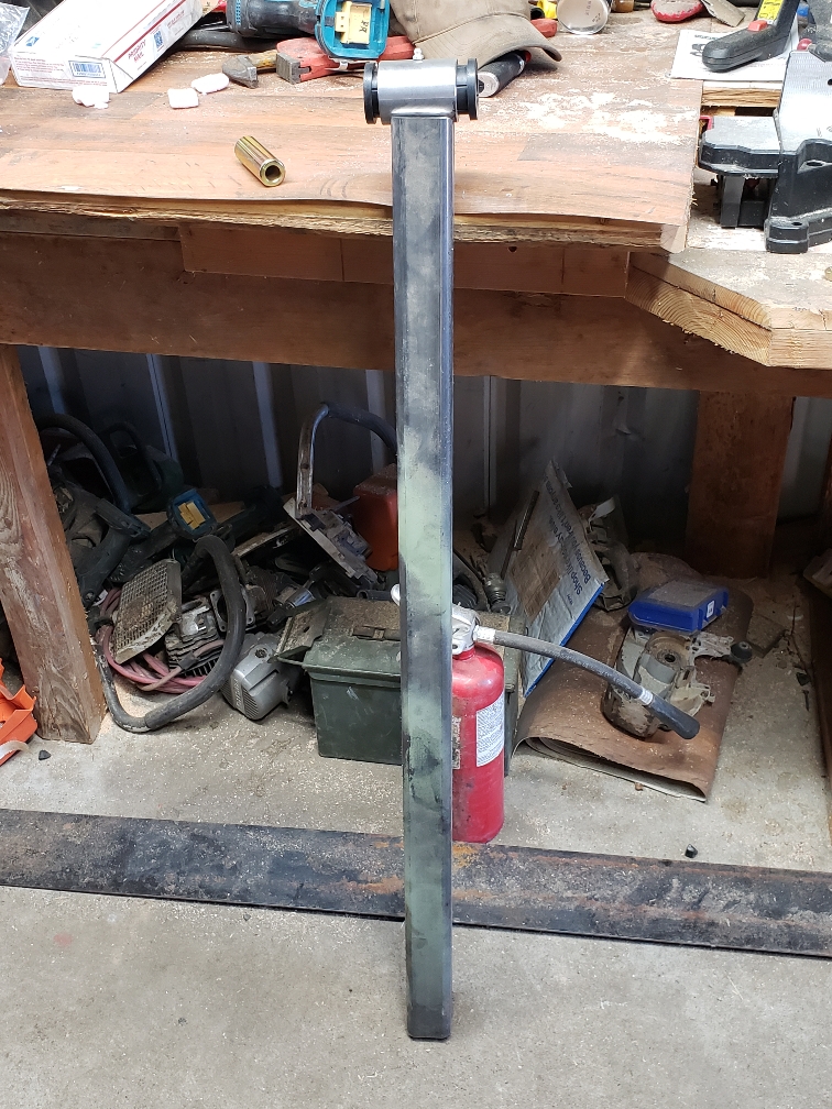

getting a better look at this before deciding on a cross section. does anyone have a ball park of how much lift will keep the upper arm from contacting the floor pan? at ride height bump stops wouldnt allow much of any travel to prevent this.
ha im trying to have my cake and eating it to keeping it lcog and 35s.

I dont think I'd be scared to make all links out of square.
This 2" .25 wall.
I think I saw mention of 120 wall. For sure don't use 120 on lowers. My pickup has 120 arms and accidentally been through rocks and offroad conditions.
Both lower links are dented and bent. That was only one outing where we ended up stranded coming home during a storm with wash outs taking culverts out of the maintained gravel rd we came in on.
Granted thts under a Cummins with hammer down in drastic situation.
My lower links are .25 dom tube and both are bent from crawling over rocks.
I never got to wheel mine before I sold it as a project, but I used 1.5" x 0.25" wall DOM sleeved with 1.75" x 0.120" wall DOM for the LCAs. No, real world durability information from me, but consensus was that 1.75" x 0.370" is plenty for smaller tired rigs.
I really like the sleeving method for the fact that each of the tubes can be used for plenty of other things around the jeep. I used 1.75" for extra parts around the jeep (e.g. - cage add ons, rock slide kickers, etc.), and I used the 1.5" for steering linkages and UCAs. Depends where you buy your metal and what lengths are required at purchase.
My arms are .120" Chromoly and only have scratches after 17yrs.

im 100% doing 2x2 lower arms, Im completely undecided what I want to use for the upper arm, other than Dom will be likely for floor clearance. what is the minimum i.d. O.D. wall tube you all would suggest for the upper?
im not sure i need .25, ide like to, but thats a lot of room I could save.

tube gets its strength from diameter more so than wall thickness. since the upper shouldnt be seeing impacts you can afford to lighten it up. 1.75"x.120 " is plenty. for the a 3 link, the upper needs to be hard joints at both ends... no bushings, enduro joints, etc.
as far as clearancing the floor... bump stop the hell out of it, or deal with it. multiple people now have said that its not even noticeable. your beating a dead horse.

on a 4 link with panhard or radius arm with panhard there is inherent bind in the system. for those designs, a bushing on the upper control arm is NEEDED.
example... a radius arm or 4 link, when articulated, drivers side compressed, passenger side drooped. the driver side arm/arms are trying to roll the pinion down while the passenger side is trying to roll the pinion up. if the system was entirely hard joints, the bind would find the next weakest link.
any easy way to visualize this... make a peace sign in both hands and point them away from you. now you have your upper and lower links. roll one wrist up and one wrist down. you can see how the left and right hand side are opposing each other. a busing is needed to combat these opposing forces.
remove one of your upper links/index fingers and now you have a 3 link.
now, on a 3 link, the single upper is solely controlling all of the axles rotation. you COULD run a bushing on one end or both, but its not needed with the bind remove from the system. and because the link is controlling all of the rotation, you will blow out a bushing very quickly from torque loads (braking, 4wd, etc).
ive even seen the PTFE liner in an FK heim wear out and cause a bit of slop in the heim very quickly. i always recommend non lined heims for the upper, keep them lubed and they keep quiet. Johny Joints have a bushing in them like an enduro joint if i recall correctly. you may find yourself tightening them more often than desired. obviously depending on your usage, your results will vary.

doing this quick visualization also explains why im a proponent for putting the upper link on the drivers side. if you put it on the opposite side of the diff, the upper link has a tendency to roll the pinion down when the drivers side is droop/passenger side compressed, and up in the opposite scenario. you are better off controlling the pinion explicitly.

- i bent 2"x.25" DOM lowers and wouldnt run anything other than 7075 aluminum. square stock may be plenty for you.
- im a firm believer on heims at both ends of the upper. a JJ pressed into the housing may do you fine. if you find yourself tightening it more than you would like... the remedy is to cut it off, install a truss, and use a different joint.
