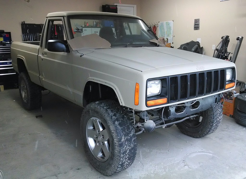

2014 MJ (code name Abby)

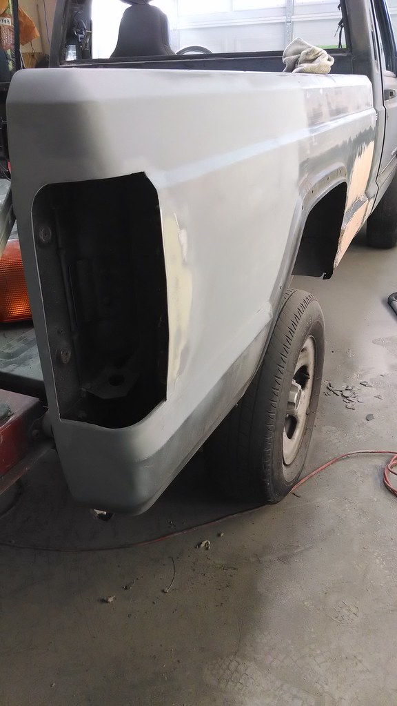

Great solution to the hard-to-find MJ tail lights. Very clever.
Agreed. I hope I get to see this thing in person when its all done.

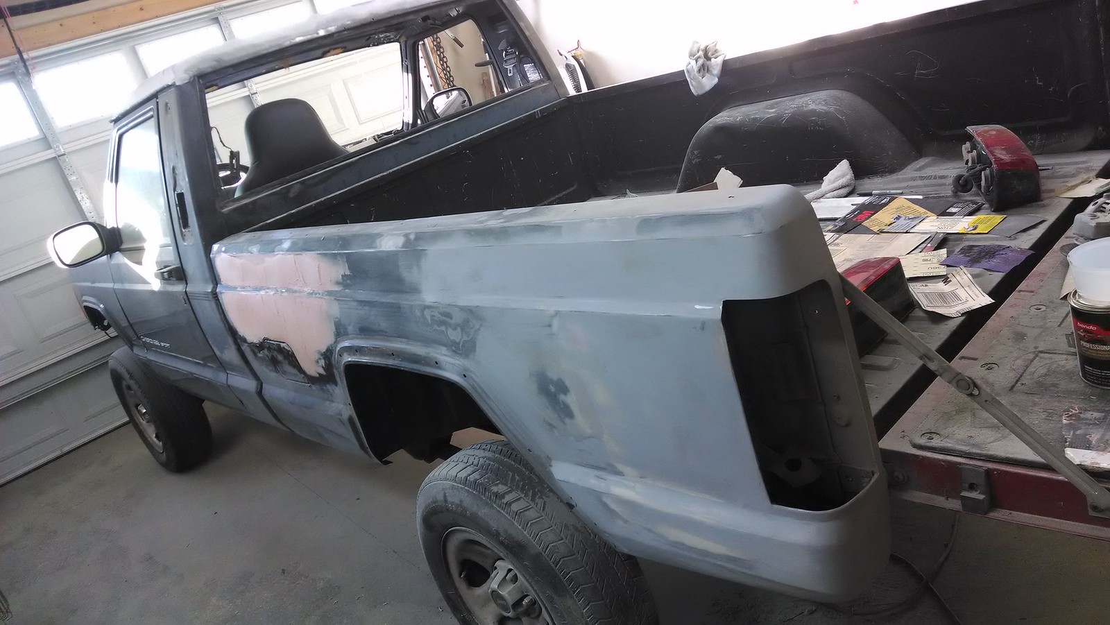

Ugh, body work, maybe it wouldn't have been so bad if someone knew how to do it right the first time, I'm finding bondo over rust and glossy paint...

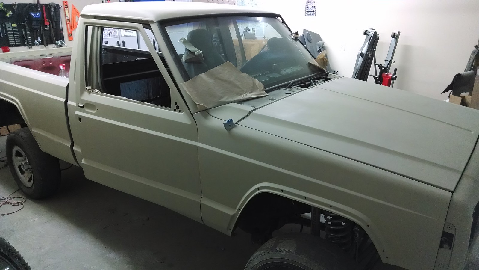

Installed hood latching hardware

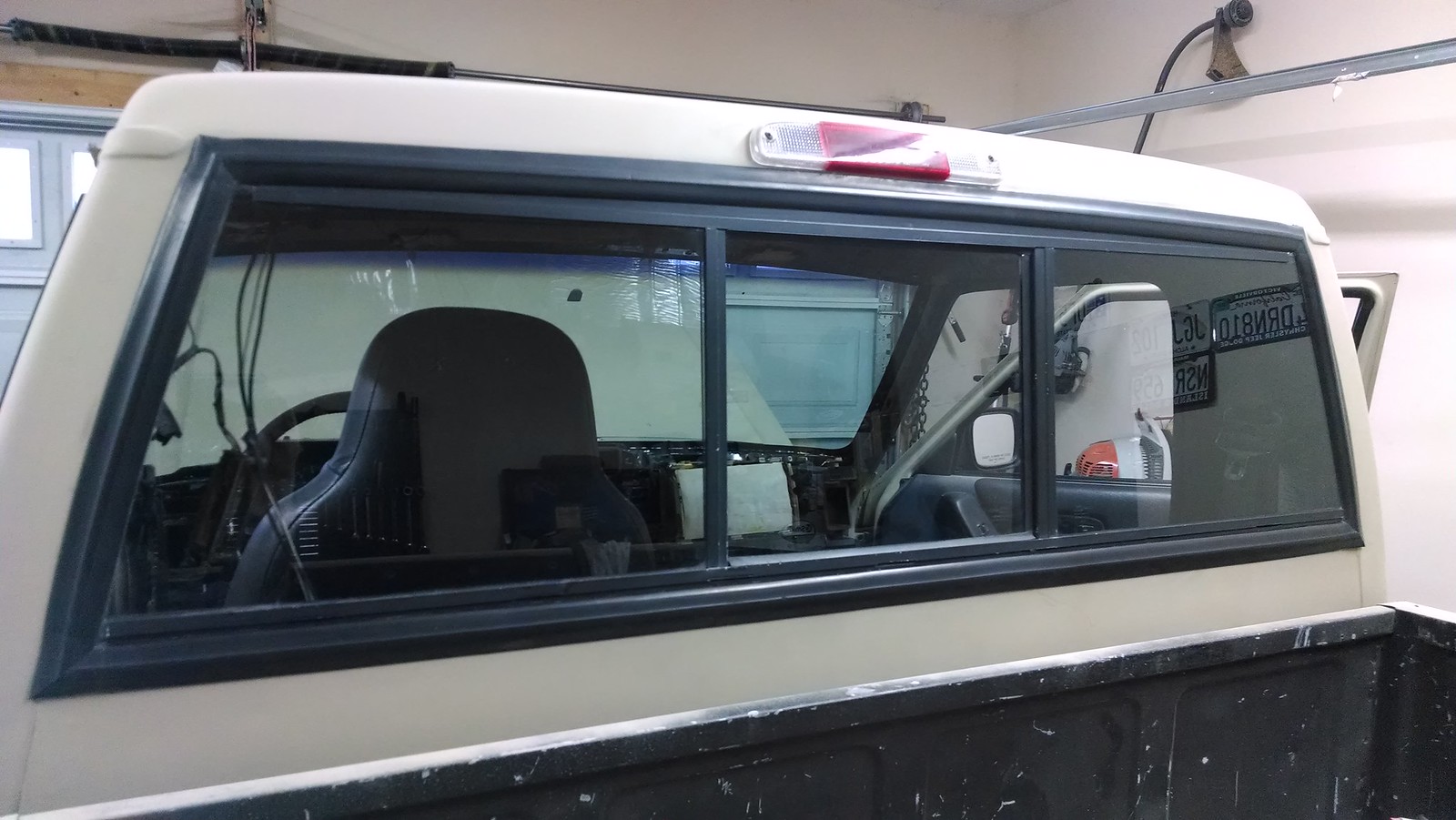

Installed HMSL/ cargo light (wiring pending)
Installed door trim/handles/locks
Installed wiper cowl
Glass is getting set tomorrow...
Got a lot done today...
-wired the HMSL/cargo light (made a jumper using the XJ tailgate harness and the tail of the donor HMSL, very clean. I wired the Cargo lights to the defroster button, also in the same harness, which illuminates on the dash as well as time delay, auto off)

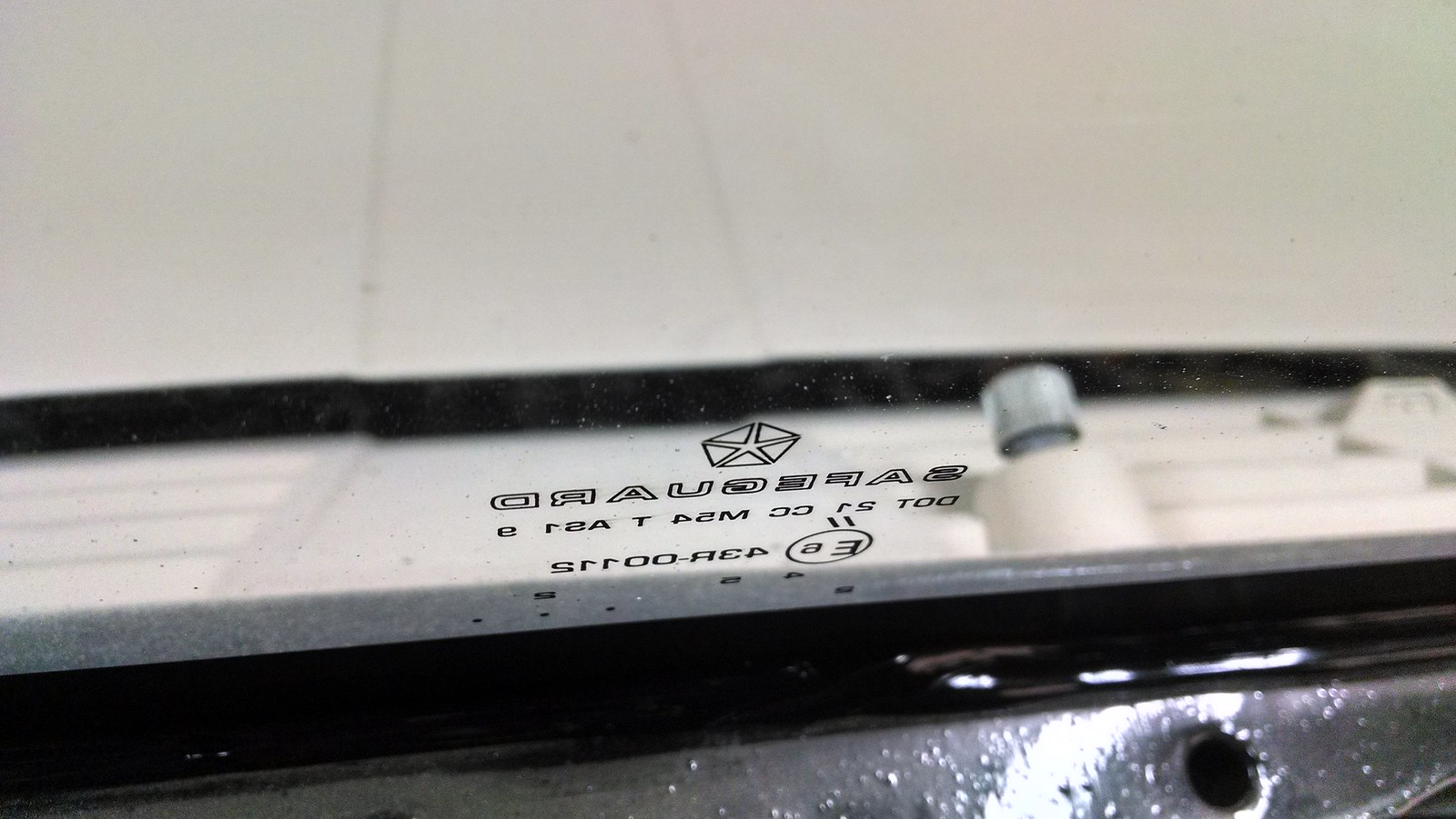

-Final install of the windshield from the donor XJ, which also happens to be an original Chrysler glass
-Reinstalled the Rear slider

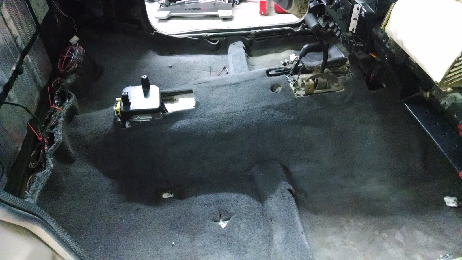

-cut and Installed the donor XJ carpet

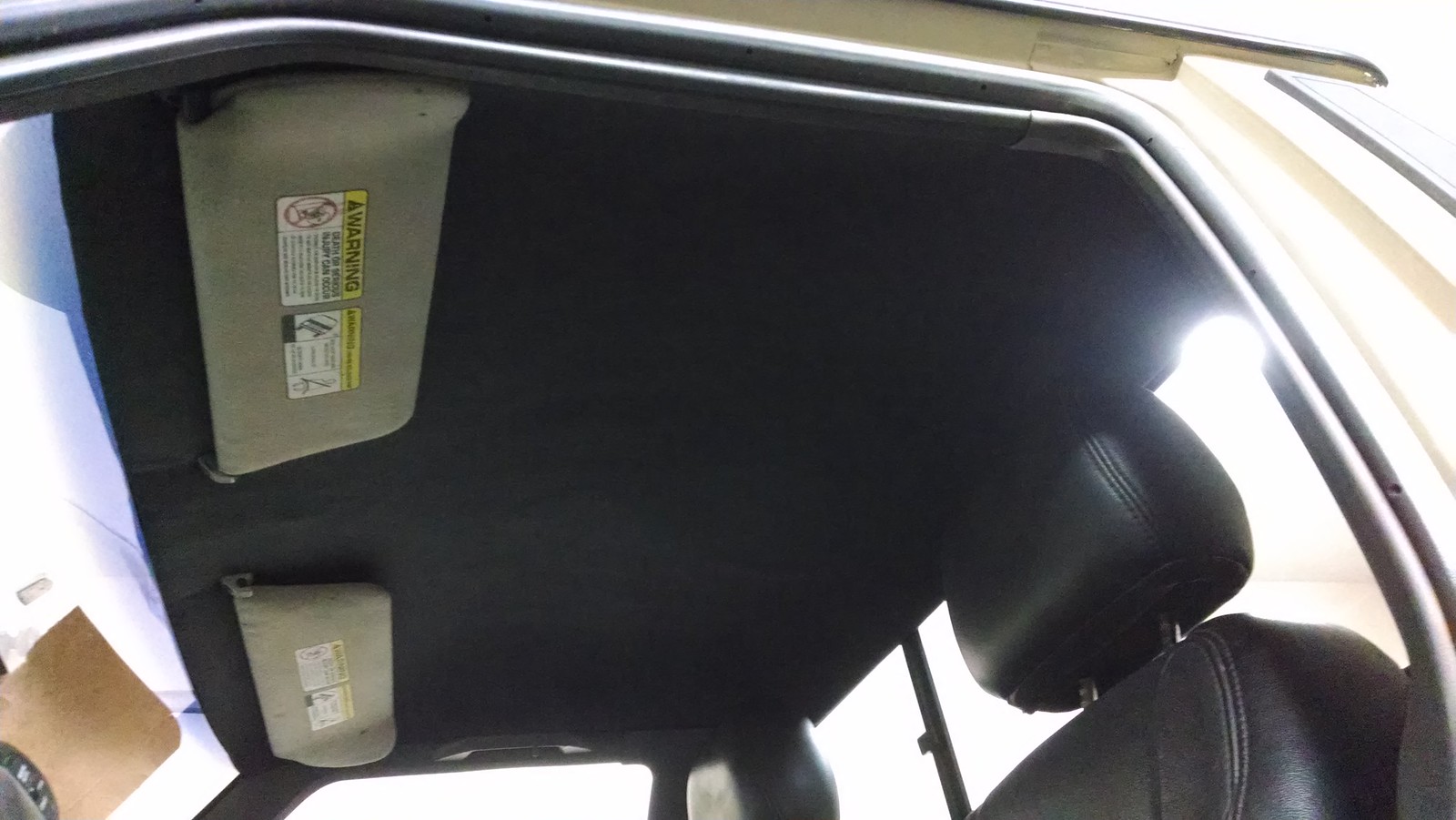

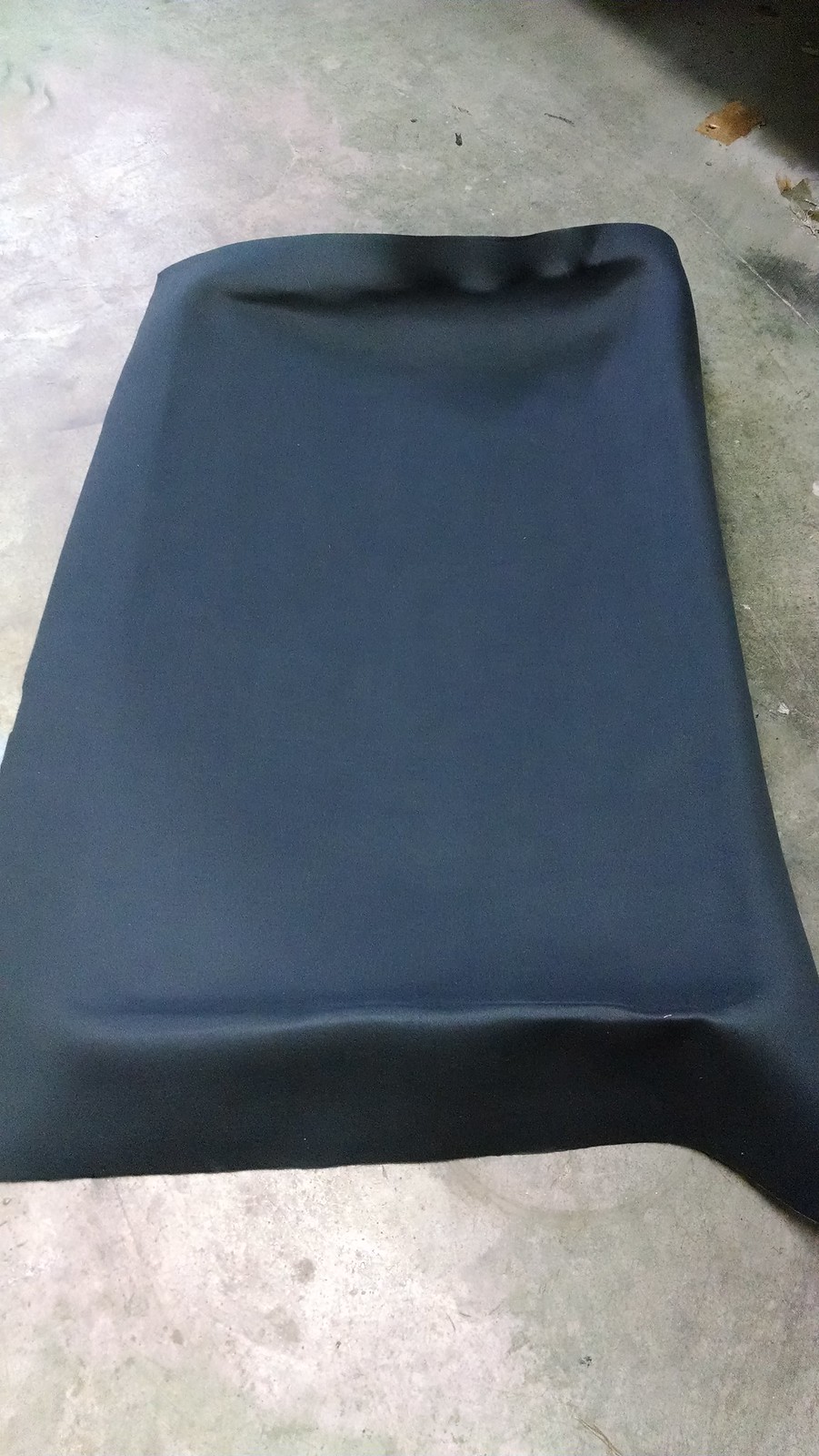

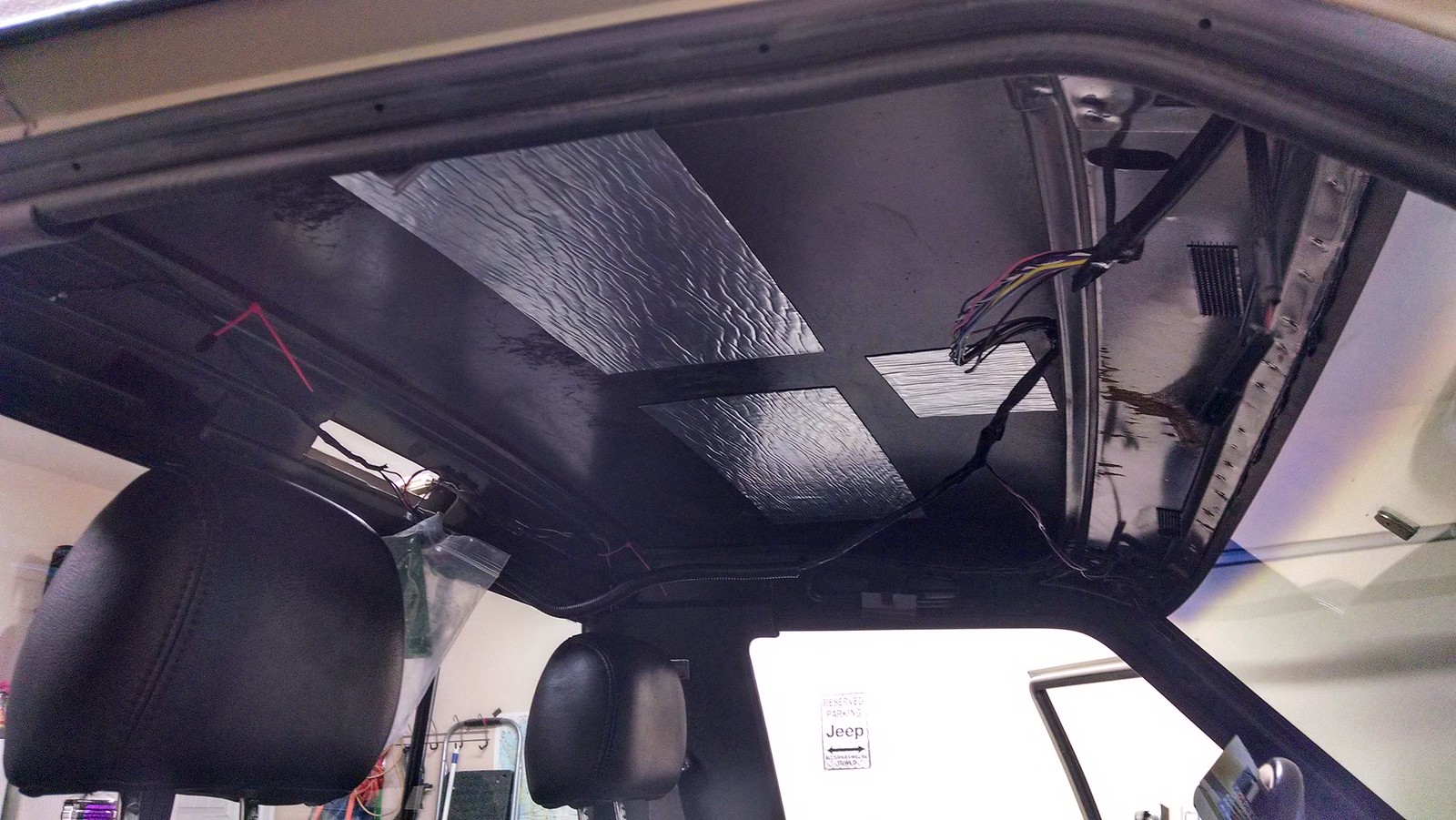

-Refinished the Headliner board with fiberglass repair and with new material and installed
-Wired the lights for the "b" pillars into the overhead XJ lights/RKE Harness
