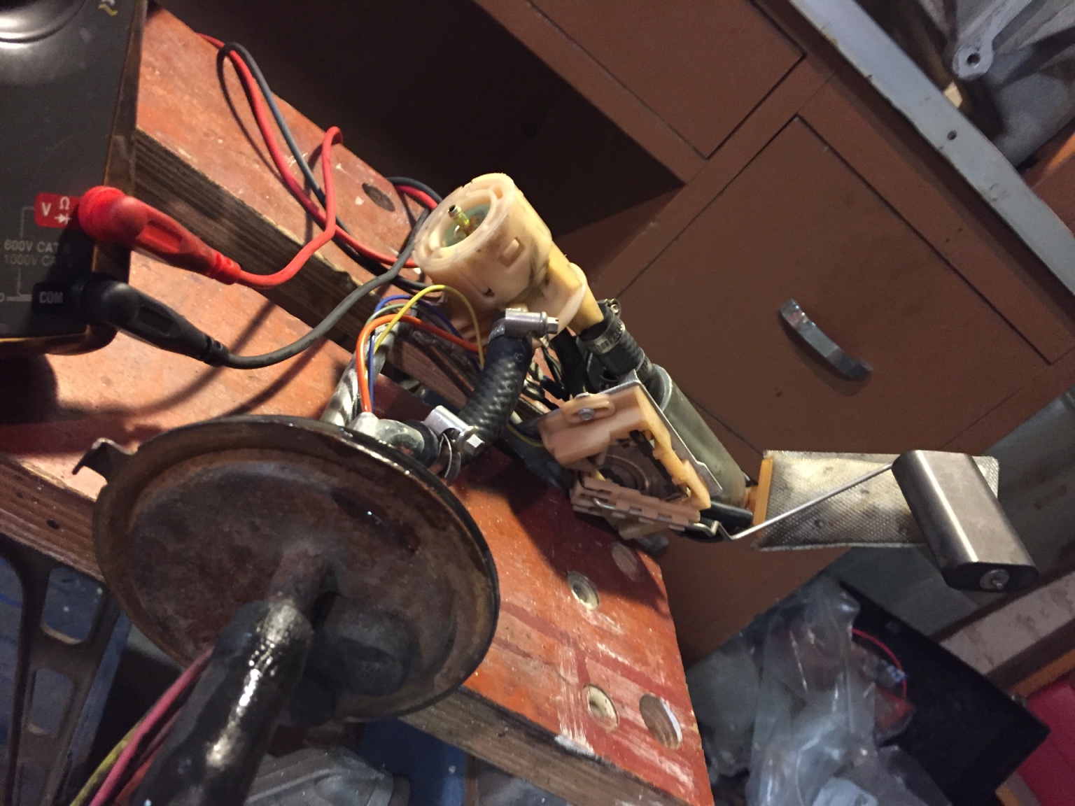

I was curious, and decided to make the $30 contribution to science.
What you get is the approximately 1" x 2" wafer that the fuel arm sweeps across. It certainly isn't going to help anybody who has a fuel delivery problem unless they can't keep track of when their tank is full or empty.
That said, it does pose some questions for me, particularly about the possibility of modifying a '97+ or ZJ tank and sending unit for use in the '96. Those units will fit, but pose a problem with the fuel gauge. To my knowledge no one has managed to figure out how to get them to talk with the '96 and down fuel gauge.
Now I just need to get my hands on a late model fuel pump/sending unit module and see what it would take to modify that. This little wafer might be the key to success.

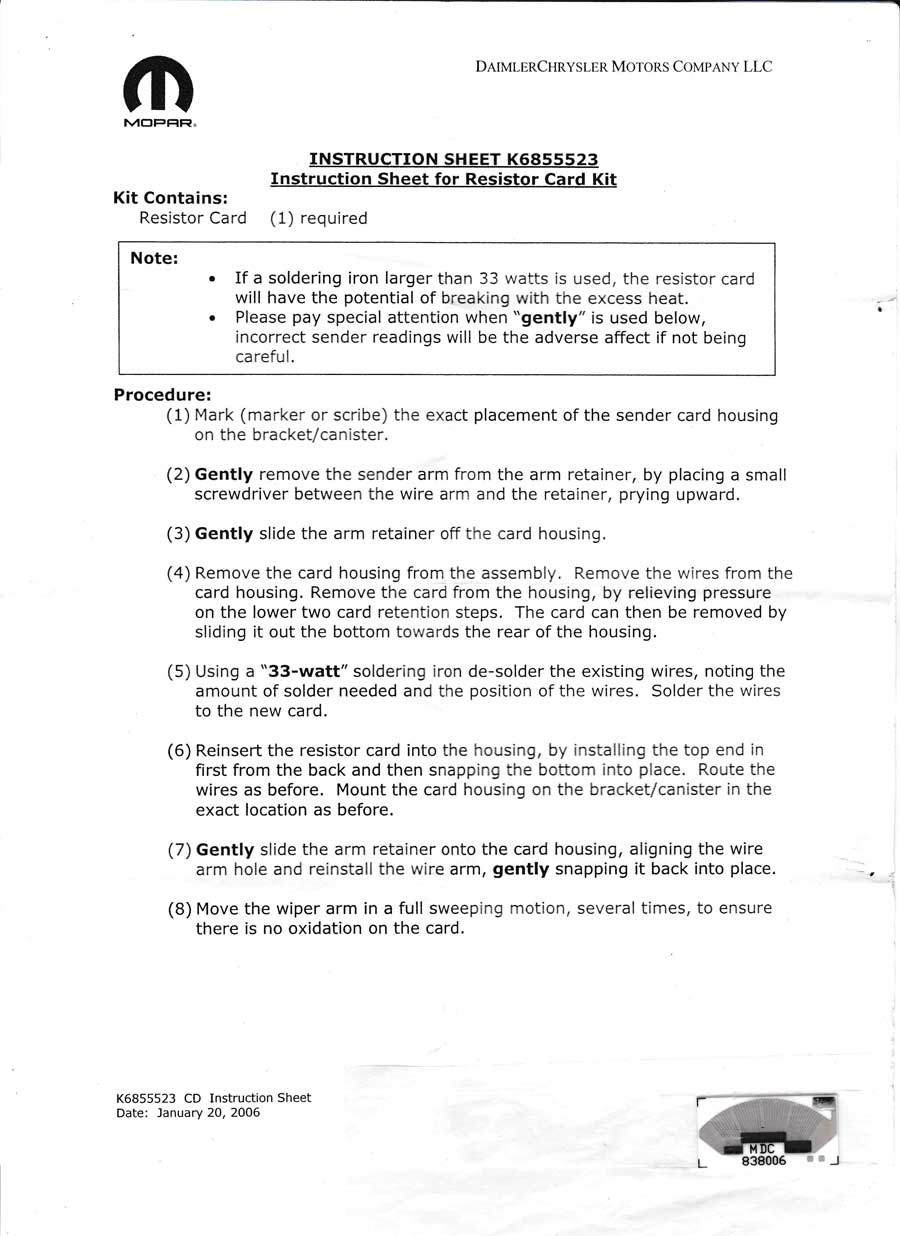

Here is what you get if you order that $30 fuel sending unit:
Note that is the actual piece in the lower right hand corner. For the sake of scale, instructions are printed on a standard 8 1/2" x 11" sheet of paper. I simply placed the "sending unit" and the sheet of paper on the scanner.
There is my contribution to science for the year.
I just measured the 96's fuel sender resistance: 1.1K ohms empty to 100 ohms full.
