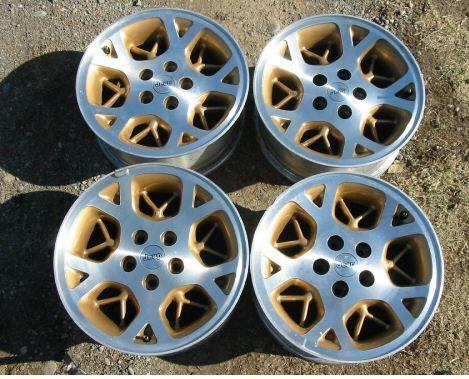

If you really want a 16" Jeep rim, you could find a set of Cherokee Limited rims (I think they go by the name "Icons") or Rubicon Moabs from a TJ wrangler. Both are 5x4.5 bolt pattern. Here are their respective pictures:

There were plenty of ZJs with 16s. I had a set of the gold honeycombs on my 95 XJ. Looked just like these.
