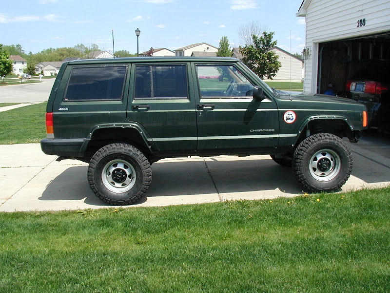

Judging by my experience with DAK pak and doing nearly the same...5-6 inches of lift and a brick will flex more than your springs. But, on the street it will look good.
Please note that in this picture the driveway has a slope to the rear but the roof is pretty level. I would guess that the rear was 2 inches higher than the front when I had this configuration. I had it like this for about 14 days.
