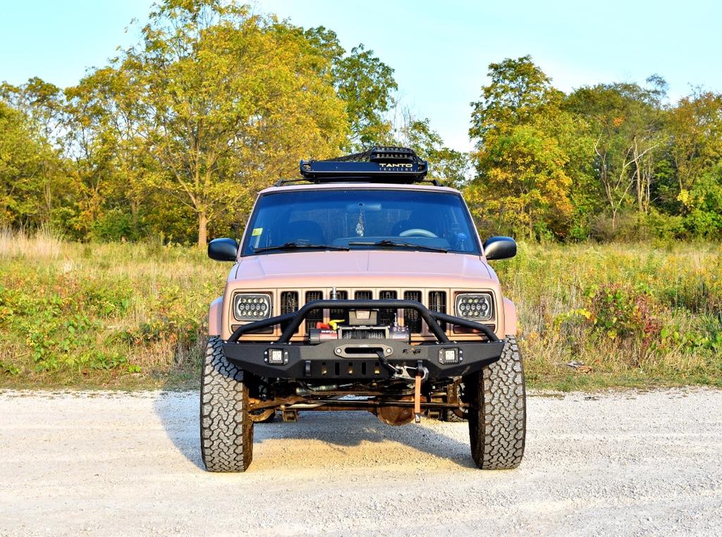

Here she sits when it was still nice and warm out round here!

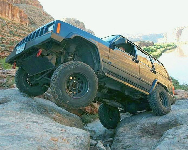

My 2000 with lockers installed was my all year around daily driver and my trail rig for many years. I also drove it 1280 miles to Moab Utah, spent the week off-roading, and then drove it another 1280 miles home again, 5 different times.
My rear locker doesn't behave much different than the factory installed Jeep Limited Slip it replaced. I prefer a rear traction device for Midwest winters over an open differential, and rear locker behaviors are easy to adapt your driving style to.
