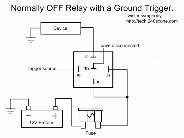

So I ditched the 2 large relay spots, for a row of the (4) 30a ones [4671168].
There's a little nub I had to chop off so the 4 bank fit where the 2 one was.
So since everything hot is right there, I'll do a ground trigger.
The 3 new hot leads are the 30s, tie each 85 to that to power the switch.
The yellow/brown/green are my 3 86s to the cabin, the big reds are my 87's.
I'm only using 1 for now, to do my driving lights, the other 2 are for future.
