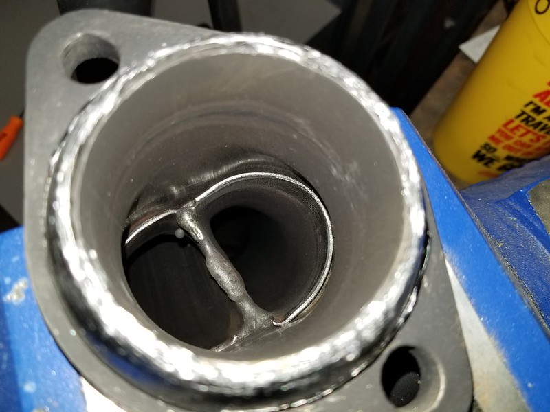

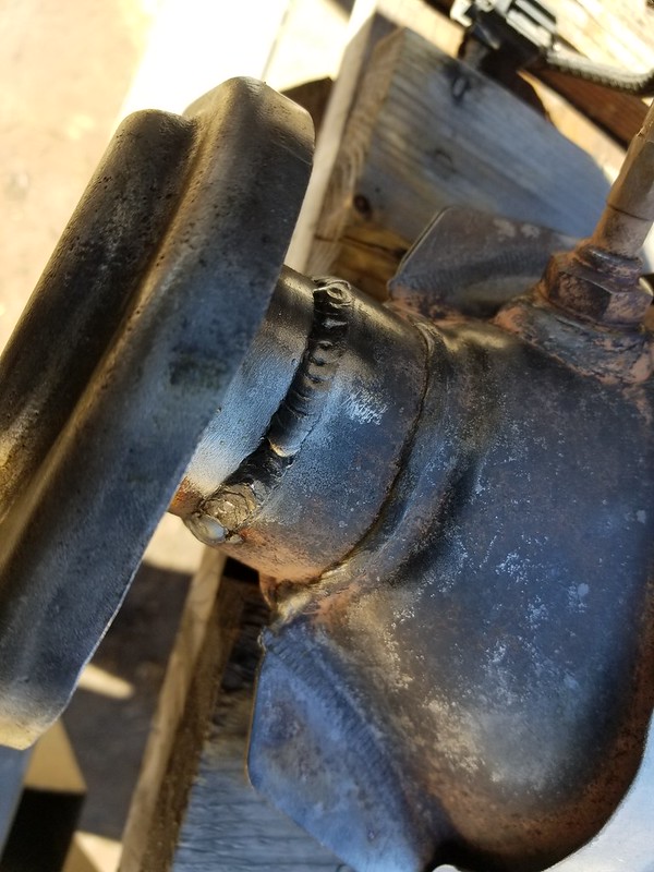

Got a new exhaust manifold:
Pressure washed it, wiped it down with mineral spirits, then applied VHT High Temp Paint:
Got the manifold bolts cleaned up and some paint thrown on them.
Most of the way back in and there:

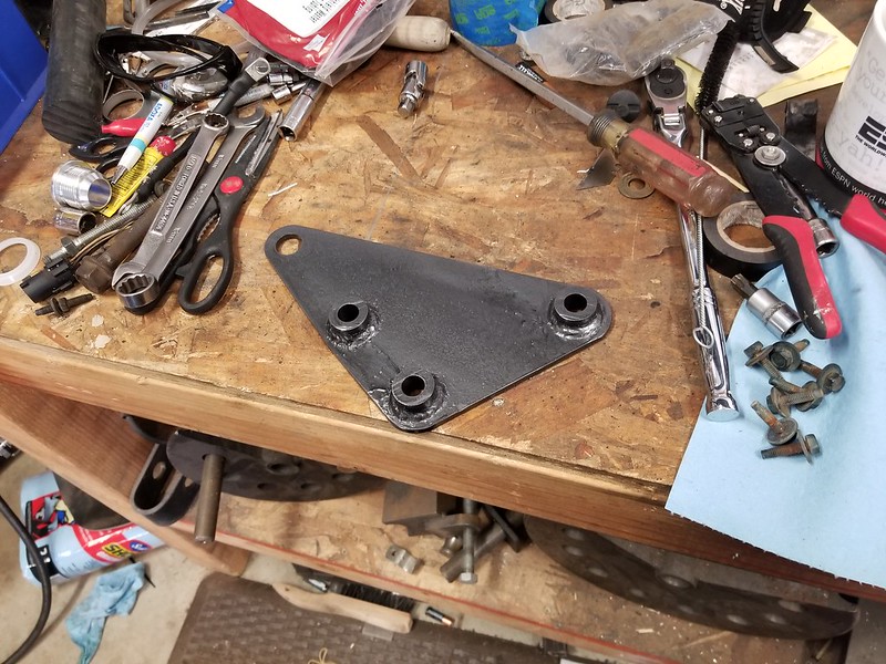

As mentioned, I got a new alternator installed.
There wasn't anything wrong with the old one, but I wanted something better than stock.
So, in my perusing around, I came across an alternator somewhat commonly swapping in, for far cheaper than normal on Amazon.
ACDelco 334-1446, Durango 5.9L - 160 Amps
Was able to score it for ~$115 on Amazon.
Install wasn't too bad. It's bigger than stock, so the bracket needs to be ground some.
Got the bracket modified, and threw some paint back on it.
Here's the only picture I got of it installed:
You can see some POR-15 in the picture as well. Below the battery box is an area the always seems to be a magnet for rust. I wire wheeled it and put on some POR-15. One spot might need to be cut out and redone at a later time.
