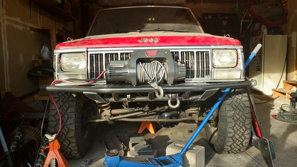

I've been trying to address the fact that while the engine is spectacular, the driveline handles like poop. I have not liked it since I put on the long arms. Too much bouncy and vagueness. I looked at buying some better Bilsteins, but $200/shock was too much. I had the average Bilsteins for a 3.5 inch lift on the beast. Amazon read my mind, and popped up some Fox Race shocks for $500 some including shipping, so I bit. My lift was around 3.5" when I bought the original Bilsteins, it's probably around 4.5" in the front and closer to 5" in the rear.
Fox claims this shock is good for 4-5". Looks good to me. Installed.
That's the front driveshaft taped to the long arm. Trying to track down vibes. No matter what I am working on with the suspension, it always seems to take every jack I have to get the crap together.
Three afternoons of working on the beast(working in the driveway, half of the time is getting tools out and putting them away) I finally got the last shock on.
I even got the new swaybar bushings in, and started on the passenger side rear armor. Woohoo. :) I can drive over the Nevada avenue moguls at 50-60 MPH with a very nicely controlled bounce and recovery. On to the vibes.
