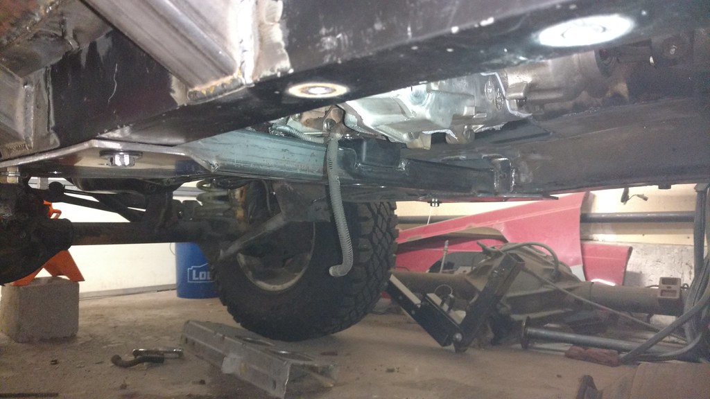

Got the cross member mostly done. Still will be adding a t case and trans skid to this. T case is mostly rebuilt. Re clocked the t case up nice and high. Pretty excited it lined up the first time. Also started on the front bumper. Hacked out the cracked factory Cross member and will be plating and tubing. Should make the winch high and tight to front. I'll throw up a pic when I get one worth showing

Been trying to figure out a good t case skid. Basically what I've come up with is just a big piece of 1/4 plate bolted on to the new cross member and one of the frame rails. I clocked the case up so it can be totally flat. I was planning on adding some 1/8x1 ribs to the the plate for some more rigidity. Does anyone think that would not be strong enough? Basically I want to be able to drag it over whatever and not have to worry about it.
Bend a hoop to weld onto the cross member. You can use lighter material for the plate that welds to the hoop.
That was actually my plan. I bent a tube up, then realized I couldn't get to the drive shaft bolts without dropping the whole thing. Ifi made it smaller it would offer less protection. So I figured a bolt on skid would be easier to work around while protecting more
Run another crossmember behind the T-Case and mount the skid to the two crossmembers. You could use 3/16 plate, or even better use some 1/8 and dimple die it, then put a sheet of uhmw under that. The dimple dies will increase the rigidity of the thinner sheet allowing you to save weight and the uhmw will slide much better over the rocks.
