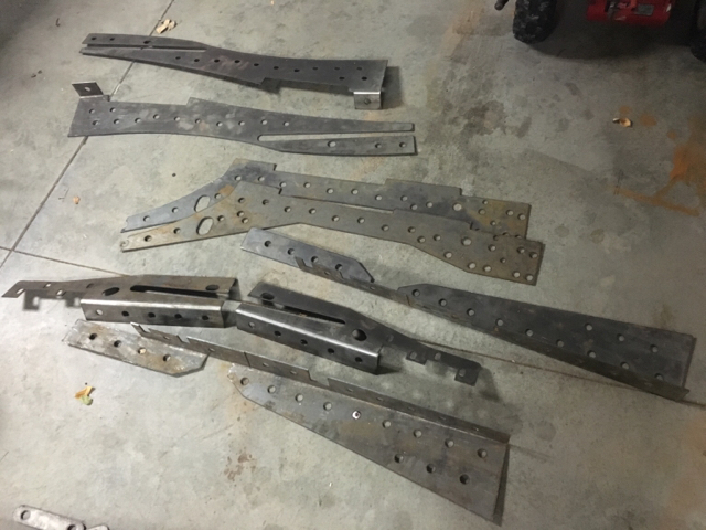

They have had garbage fitment for years. i talked to him after having to mod mine some thing like 4 years ago. Good luck getting things changed.
JD over at www.offroadarmor.net cuts them now and has a far better fitting product.
would you buy them again if they were changed? I'm on the fence whether to get them or not. hopefullly they fit better
Yeah I would buy them again if they were cut different. Definitely would save time. I would have been better off making my own, though.
i bought and installed a set of those stiffeners. the fitment was garbage. i worked with the company on how to change them so hopefully they updated the laser program.
My fronts fit pretty well actually. Once I got to the under cab portion, that's when things went south lol.

Made some mid body frame stiffeners to compliment the HDOffroad fronts that we put on last weekend...
