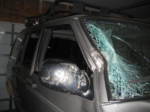

Damage report:
-vehicle was layed on the passenger side "A" pillar and pressed in about 4-5 inches into the windshield, pulling the roof down about 1 1/2 inches in that corner and placing a kink in the roof at that corner.
-vehicle also layed into a tree or pole on driver side rear quarter from wheel arch to drip rail and pressed in about 1 1/2" on the roof edge
-various dings all around, but overall a very, very clean

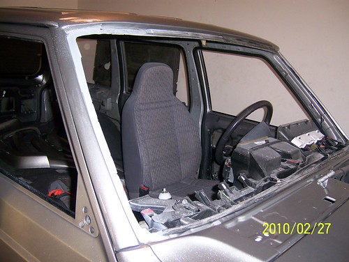

started like this...
repairs...
and currently (just back from paint)...

It looks like someone trimmed the front fenders, looks like you replaced those as well??
Nice work overall
Thanks, yeah I kept the factory color, it was too clean to change,
and yeah they were all trimmed but the fronts were flimsy and had a slight bend in them, not worth repairing to me, I got some nice ones from the local C4C lot, I want to run fender flares, I like the look and protection.
