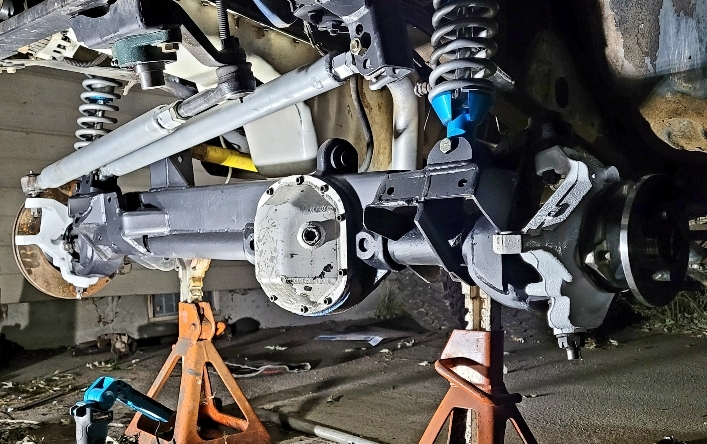

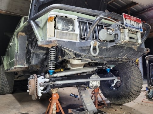

My WJ swap setup, which I've run since 2010. https://www.naxja.org/forum/showthread.php?t=913774&page=9
I also run Teraflex HD JK Ball Joints, which fit the XJ D30 inner C and the WJ knuckle taper.
Recycled 1ton steering

My first one I used the Rusty's OTK as it had rubber bushings. I don't know why I don't like hiems for road use. I think there were 3-4 offerings back then. My present one is mainly Stinky Fab. The actual track bar is a fabbed piece. I started with an RE bracket, to use with their Track Bar brace. The Ironman axle bracket didn't work out. I think the WJ's arms would contact them. He referenced the Rusty's. His eyes popped out with the Stinky's. They are beefy.
On the first one, I didn't have a steering stabilizer on it at first. It drove great. I added one latter, as for DW. Yeah, doesn't help. I 'upgraded' it to Ruffstuff D30 cover and an OME WJ stabilizer shock, from a Tenneco. Really, little help. On my 2nd one, I do not have a steering stabilizer as of yet. Really, no need.
