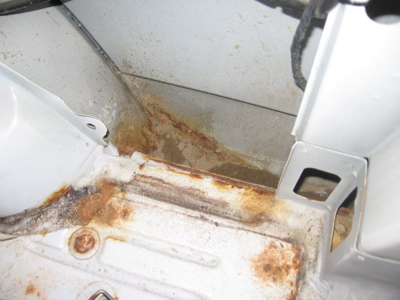

Ok good pics! Well first if you are going to "weld" them remove the trim!

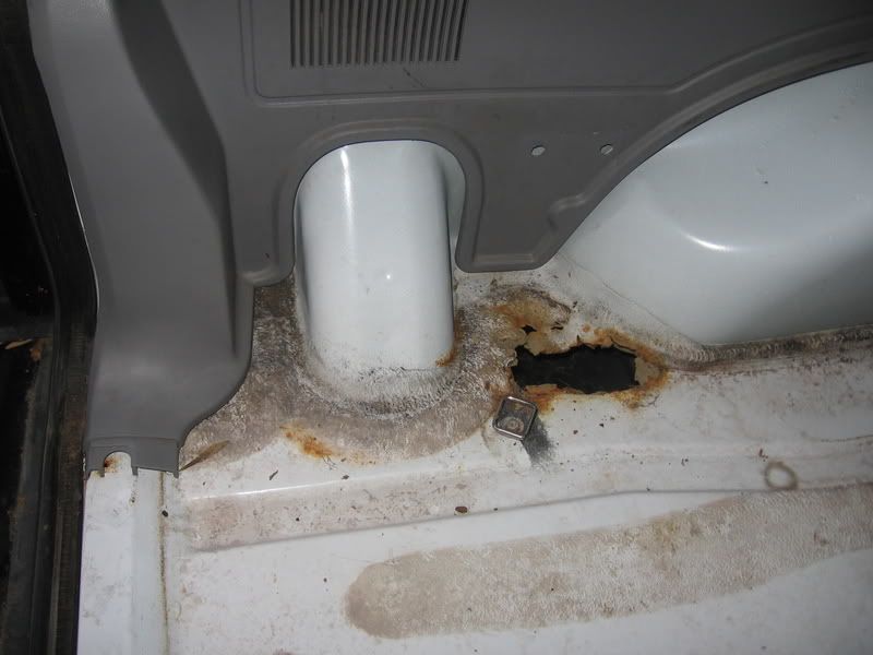

Ok first thing is first; It looks like you have some mud or dirt in the well behind the rear passenger wheel well get rid of that.
Are you just wnating to fix the rust then put the carpet down? Or are u wanting to herculine the floor?
I kinda need to know that before I can say much more I dont want to send you off in the wrong direction you know!
BTW Where are u from?
I'm on the coast of CT (Milford) Its about 20 minutes from New Haven if that helps. Anyways, yea i meant to caption that one w/ the dirt in the wheel well, that is b/c down there, there is a whole too. Anyways, no carpet, i'm done w/ that smelly stuff and i'm not going to bother w/ it anymore, i do want to keep the trip though at least, and then herculine or whatever is most cost effective. As for how smooth the floor looks when i'm done, i'm not gonna be picky about that stuff, so if its easier to cut peices and overlap the metal i dont really care if its higher or lower than the rest of the floor, i'll just apply whatever coating i use thicker or thinner in those areas to smooth it out.

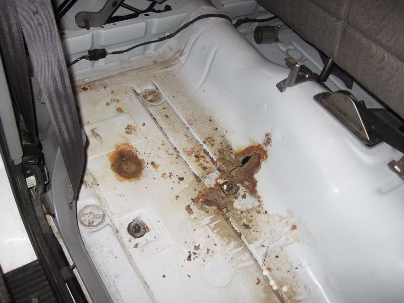

Not much farther, i'm hesitant as to how to seal up the new patches, i bought sheets of 18 and 20 guage...and i cut out the excess rust and grinded the rest away so i basically just need to get those patches welded up somehow....and seeing i dont have a welder i dont know what to do...i didnt want to spend money to pay someone to do it but i guess thats the best way to go right now huh? Let me know if the cold weld will work for something like this instead, otherwise i cant think of any other way around it. What do u think?

Just have a shop weld the patches then go over them with the jb weld to seal them and for an extra measure get some black silicone and and go over the bottom and the top of the patch to seal the metal. Don't for get to rubber coat the bottom for more protection!
And the reason that the floor pans rust out is the Drain plugs they put in the floor. The is about 20 of them all together
Have someone weld them in, that way you know its done right. JB weld is a great product but I wouldn't be using it for structural purposes...remember your floor pan is a structural item, not just a place to put your seats.

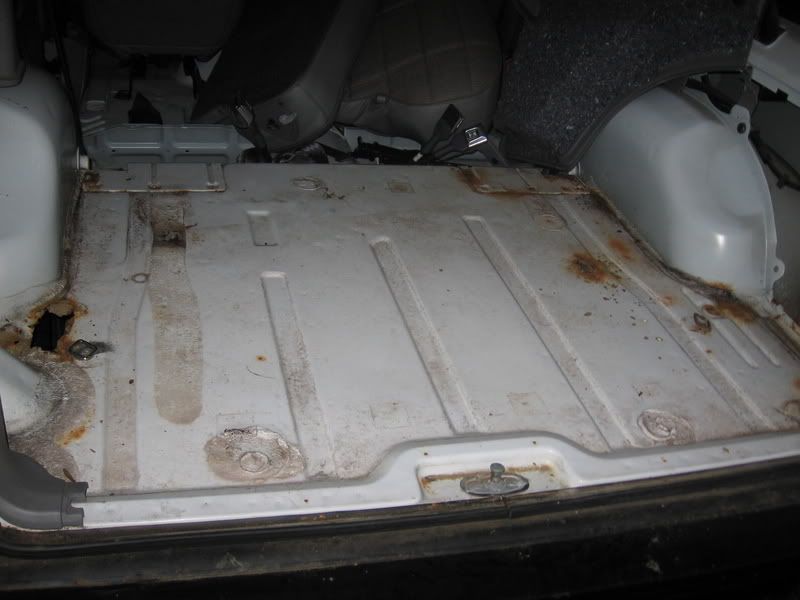

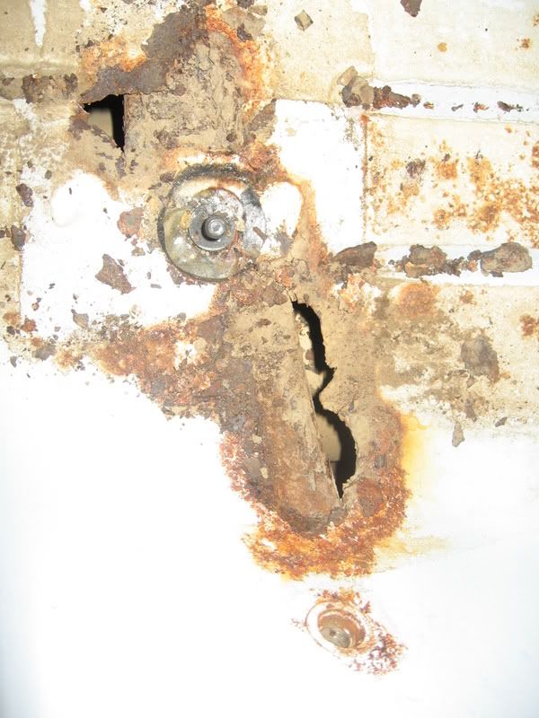

Thanks guys, i bought a cheap craftsman angle grinder today b/c it came w/ a 1 year warranty...so i figured what the hell...i have most of the rust spots grinded down, and now i'm left w/ the few holes that i have...is there anything i should do to prep the holes before i have the shop weld in the panels...and should the panels be welded in from the top or undercarraige? I'm assuming top? Thanks for walkin me through this again.
Just make sure that there is about a 1/2" of bare metal around the holes. Now that hole that is in the back behind the drivers rear wheel well youll have to drop the tank or just JB weld that one in there The fuel filler line and the tank breather are about 1/2" from the bottom of the floor and that rubber will catch fire instantly! Make sure that you have all the area under the hole free of debries and any hoses or lines. Weld the panels in from the top!
