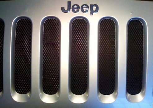

It's looking really nice! How about perforated steel behind the slots?

I was looking at the JK wranglers and noticed that the slots have a little bevel at the bottom and i thought it was cool so im gonna adopt it. with a bit of shaping and some fiberglass they should look sweet.
