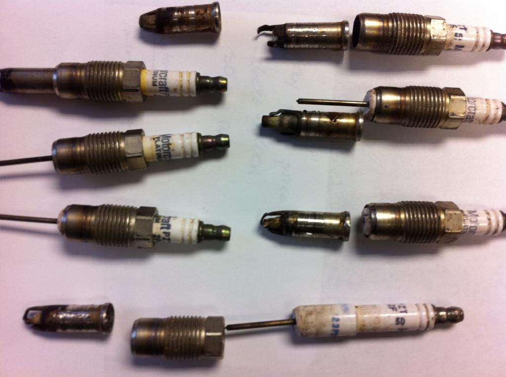

don't buy a 5.4 the motor is a dog and doing spark plugs is a bitch, they like to seize and brake in half in the head, or they just come flying out as your driving.
^^^ This. The 5.4l sucks. Its under powered for a truck and those are very accurate spark plugs pictured from a 5.4. I'd take a chevy 6.2l diesel over the 5.4l ford and the 6.2l is a pile of dung. Save up and get an F250 with the 7.3l or a Dodge 3500 with a cummins.
Those plugs are fords response to the older style that would blow out. The only time the older style blow out was when whey are replaced and not tightened properly.
