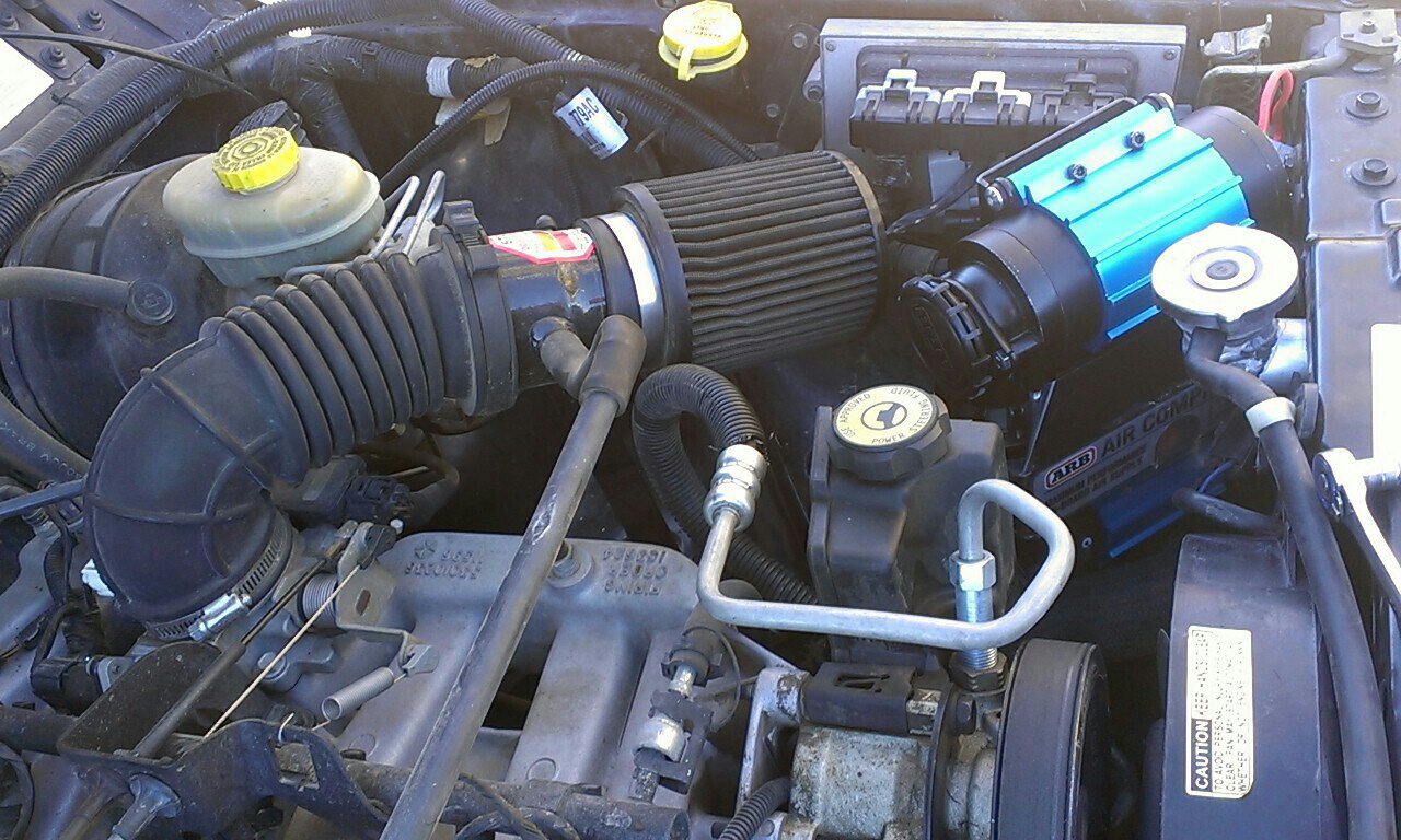

Where to Mount the ARB Compressor?? Interior? Engine Bay?? Install Tomorrow!
I mounted it in between the brake booster and the air box... turned out great!!! i appreciate everyone's input!!! I'll post some pics later on!!

I mounted mine under the engine bay, but if I had to do it again I wouldn't hesitate to mount it in the cab.
Here's what I did, its been awesome.
