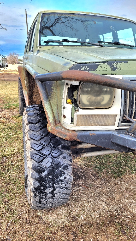

I have 305x70 16 Cooper STT Pros now with 4" of backspace and no rubbing.
Yeah, control arm choice and tire width are going to be the main factors in the max possible backspace. A 305 is ~3/4" wider than a 285, so dividing that by 2 is ~0.4". Would seem to suggest that a 285 with 4.5" BS should work or just barely rub. For sure 285 on 4.25" BS will clear if a 305 on 4" BS clears.

I am running 305/70 16 STT Pro with 4" backspace and 4.5" lift. Had them for a few years now.
