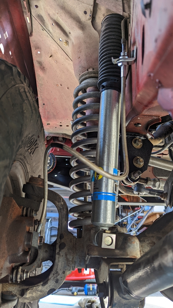

This weekend, I managed to get my front springs pulled. The bolts for the lower bump stop extensions were completely seized up and had to be destructively removed...
Working on getting some Prothane bumpstops all sorted out. Then onto the steering assist ram. also need longer brake lines...

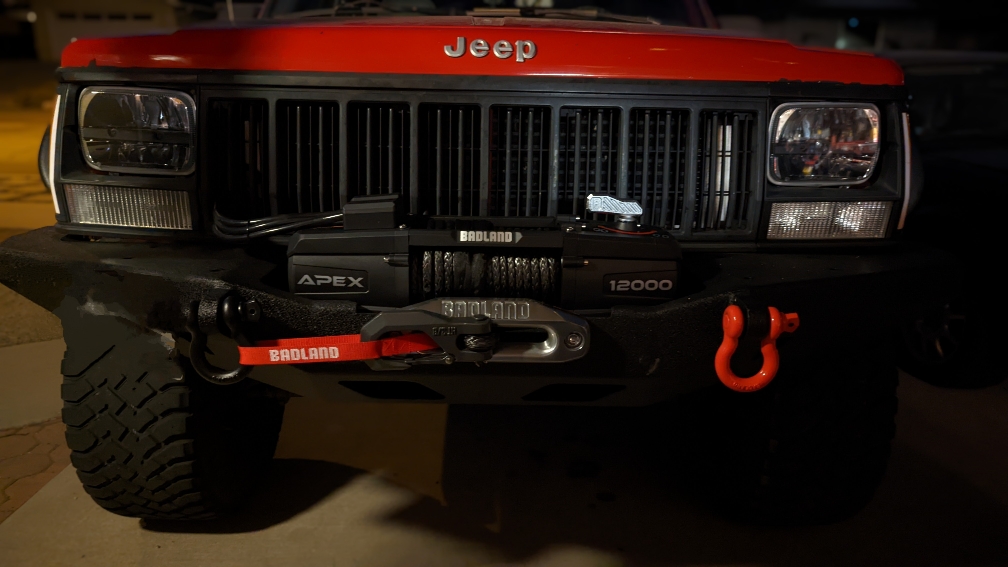

Got my new harbor freight apex installed! I love how the control unit fits nicely in the engine compartment. Also new braided front brake line extensions yesterday.
Sent from my Pixel 6 Pro using Tapatalk

Finished up the inserts for my front prothane bump stops :). Ready to tack the ram on and check for interference during articulation.
Current issue is that my tie rod contacts the differential cover nearing full lock in either direction. the cover 3/8" thick, so hopefully i can get the clearance i need with a grinder. If not, looks like the welder will get invoiced. I have yet to weld anything that needs to hold fluid, but how hard can it be.. I was living with that before, but want it fixed before the hydraulic ram gets into the mix.
