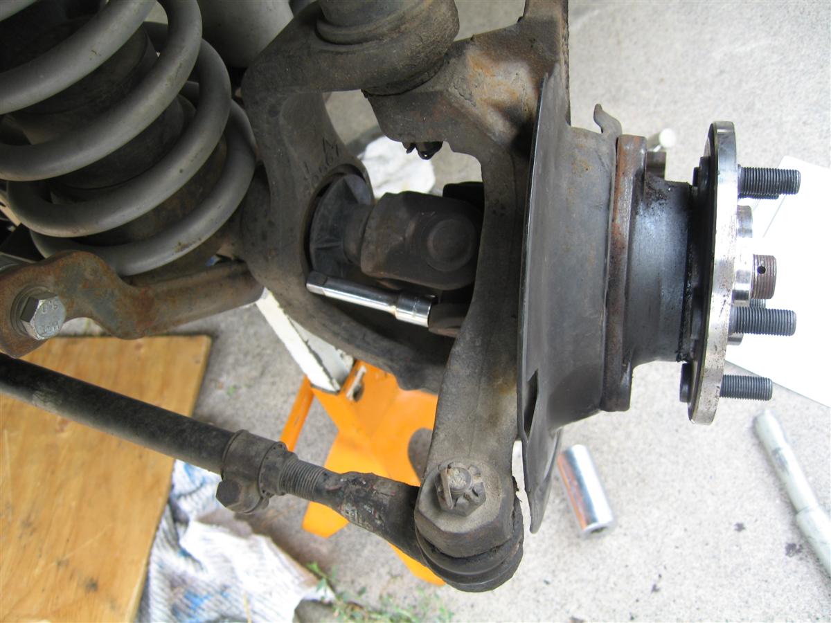

I used a piece of 1x2 box metal tubing as a spacer and the power steering to push the bolts through if that makes sense.
yeah just seen this
the 36mm isnt, I thought you could pull the shaft/unit bearing at the same time. Thats how I remember it, but its been awhile since I worked on a d30. I dont think this one has ever been apart...
you can, i've done it that way before.
my method for getting them off destroys the dust shield, but if you beat the hell out of that with a hammer they tend to come off.
You can, a trick that works real well is to screw in one of the 3 unit bearing bolts a few threads leave a socket and extension on it so that it touches the knuckle then turn the steering wheel, I hope that makes sense.
