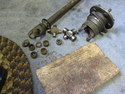

I noticed some play in my front axle u-joints a couple days ago. I picked up some Spicers to replace them, and dug into the project today. I was shocked when I was able to remove the drivers side joint by hand. The ears on the shafts were stretched so bad I ended up using my spare shaft to rebuild instead. The splines on the inner shaft were also fairly twisted as well. That shaft/joint had over a year of wheeling on it, so I can't complain too much.

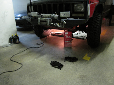

i did my passenger side u-joint on sunday.
i wish it was as easy as dustin's.
ha!
i can never get that darn harbor freight tool to work for me.
it seems like it gets out of alignment as i tighten it - EVERY TIME!
also, the tone ring made removing the c-clips a real @#%@)#(%
it wasn't so bad on the drivers side last year..
it just seemed like i couldnt get much of an angle on those puppies this time around.
this was also the first time i left the hub on.
i dunno why i ever wasted time separating the shaft from the hub in the past.
although, it was a bit more awkward removing the shaft with the added weight.
(i totally drug my splines through some dusty rusty goodness in the tube as i pulled it out)
but they cleaned up fine.
