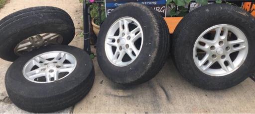

I need new tires with an E load rating, my current 15s just wont cut it. Found a set oem set of 4 16” wrangler alloys semi local for a good price
Will they fit, first. Second, can i squeeze 245/75-16 in the wheel well without trimming or lifting? Suspension is all brand new, HD springs front and rear. No sag, top center of wheel arches measures 33”+ from ground

I don't recall that wheel on early wranglers (5x4.5"), are you sure those aren't 5x5"?
I think RCP is correct. I bet those are 5x5.
But I bet they will work just fine with spacers.
As to running 245/75r16s, I think you have a reasonable chance of fitting those. Hopefully someone can chime in who has a close enough build to yours to be able to confirm or deny. My '96 (not quite the same fender flares as yours) sits with the wheel arches at 34" on 30" tires. I know that I can clear 245/75r16s on Icon wheels.
Thanks guys. Doing some research on the googlenets, those are grand cherokee wheels and not wrangler. I thought something looked odd...pretty sure 99+ grand cherokee
