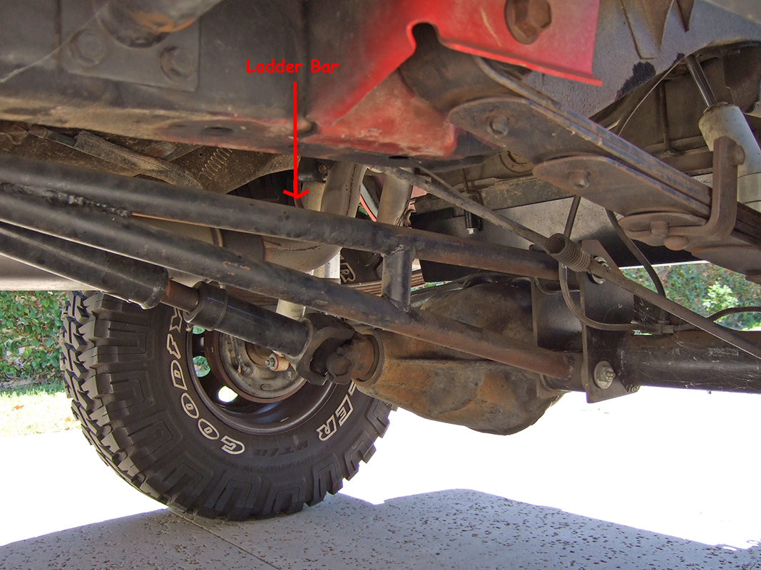

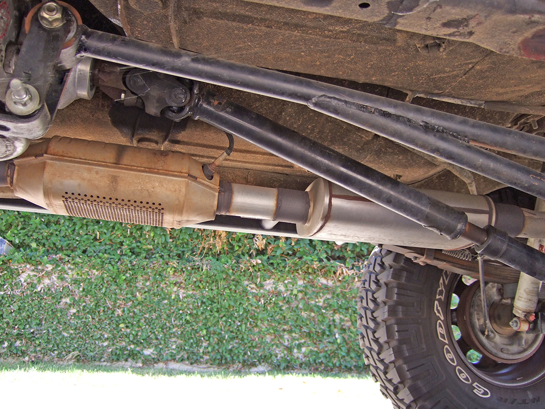

To keep you from wrapping your springs.I use this one with 1.5" blocks.If I go to the TNT ube's, I'll use the same setup.
Do I need this? I will be running 4.88's
Can you show me how it mounts on the frame end?
Where would I get this, and how much?
I wonder if I could integrate a mount onto The TnT belly Skid? You say i probably wont need it but im just thinking out loud. Whould the pivot point need to be inline with the TC output yoke or does it matter?
Well its definitely something to consider.The 1.5" ube is pretty much the same as a block.The front is a johnny joint and shackle welded to a currie cross member.I got all my ladder bar parts from http://www.sams4x4store.com

Some call it a traction bar.... some ladder bar... maybe he was confused... It's not really needed until you're crawl ratio gets pretty low IMO... OR you start breaking things..
I personally saw my my RE springs start to wrap while watching my brother drive my rig in the rocks near Johnson Valley.I freaked out and immediately went to work on the ladder bar when we got home.I run 4.56, a detroit, and 33x12.50 MTR's.Again the lift is a 5.5" Rubicon Express short arm kit with ACOS in front, and 1.5" solid steel blocks in the rear.
I'm swapping in a 33 spline chromoly detroit locked D44 with 4.88's, and either the TNT ube's or my current blocks and steel degree shims tacked to the blocks, and I will definitely be swapping in my ladder bar.
One thing to consider though is the width/length of your block does not compare to the width/length of the UBE... Blocks will definetly add to wrap.. the UBE's not necessarily.
