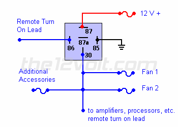

I would put in a relay that is triggered from the ACC line, this relay will cut and activate the existing headlight circuit. Simple and you don't have to worry about new fuses or anything.
Cut the wire for headlight power, and connect from fuse panel to 87, connect the output to the switch to 30, connect ACC to 86 and ground 85.
That should make the switch only work when ACC is on.
And this will work like I want it to and the switch still work and what type of relay should I use and what wire color is the hedlights on the fuse panel
