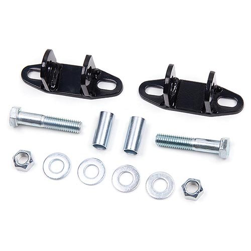

^^^^ZONE OFFROAD on Amazon
SO now, finally, my question is, what manufacturers offer BOTH front and rear Bar Pin Eliminators that DO NOT rotate the Shock orientation. Also, while I’m at it, are there any BEEFY front Upper Shock adapters/mounts available????
Bar pin Eliminators that do not rotate the shock mounts:
JKS (Very inconvenient)
Iron Rock Offroad *FRONT ONLY (rear do rotate)
ZONE Offroad on Amazon *Rear only, no front avail.

I decided to order another set of Iron Rock Offroad BPE's for the Front of my rig, and I ordered ZONE Offroad for the rear!
