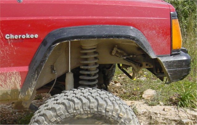

I am running 32x11.5R15 Mud Terrains on mine at 5-5.5" of lift. I trimmed the front fenders level with the side markers and had to trim the flares too at the front. Have a look the picture below:
After this picture was taken, I did some more trimming at the front, but I do not have a newer picture. Please keep in mind, that at this moment, the front wheels are a bit more forward than what appears at this pictures, due to the installation of the RE drop brackets, so no need to trim the rear of the flares.
At the rear, I just folded the lip of the fender flat. No need to trim the flare, at least for now.
