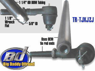

Jeepinoutfitters has Big Daddy tie rods for 69.95$.
http://www.jeepinoutfitters.com/scripts/prodView.asp?idproduct=109#
