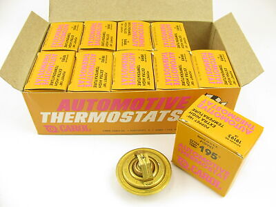

These are the T-Stats I am using in my 2000 XJ :
I had to trim the T-Stat gasket though.
