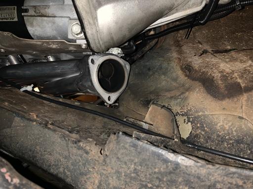

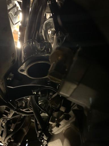

Some photos of the exhaust before it goes in

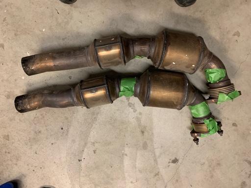

The camaro cats

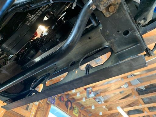

Drivers side. This side is very tight! Not sure how the exhaust shop is going to make it work but they have done impressive work for me in the past and will pull through.
Passenger side looks easy

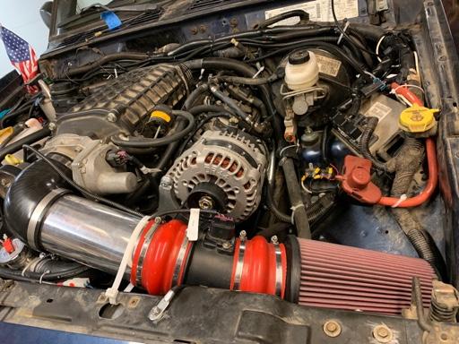

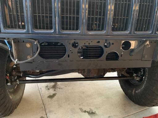

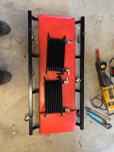

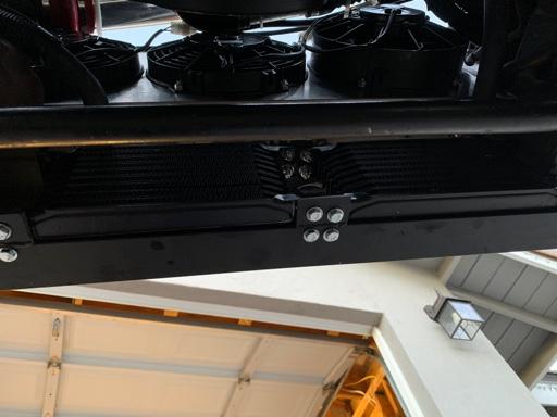

Got some work done on the intake and the intercooler.

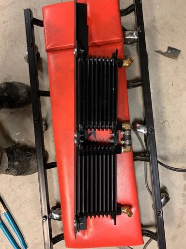

The intercooler reservoir
All mounted

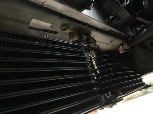

From the bottom, here you can see the three radiator fans as well.

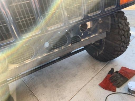

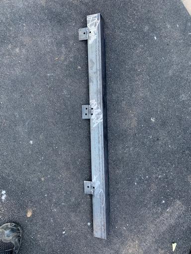

Bracket welded on and painted. Speed holes cut

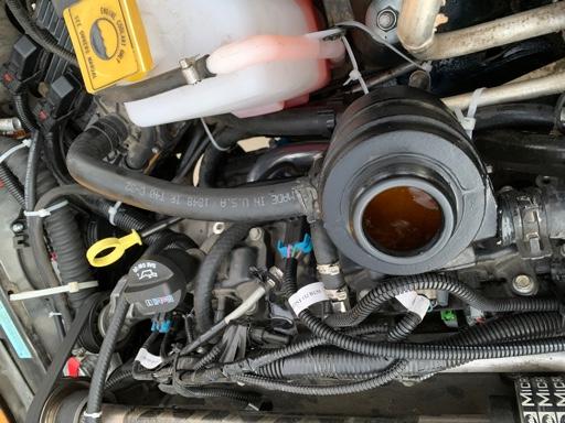

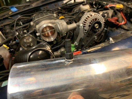

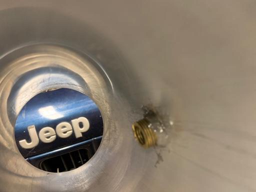

Intake finished. The filter from the camaro was too wide to fit under my future hood. I cut a chunk out of it for the MAF sensor adapter.
Thi inside of the pipe with the breather valve.
Breather valve.
