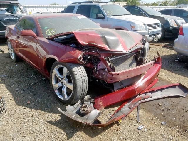

I went through the a giant hassle to be able to buy cars from online auctions and bid on a 2010 Camaro SS. The hood was smashed and electrical down so no way to tell how many miles or really what engine was actually in it. I big risk, I know. I bid and won the auction.
[/SIZE][/FONT] After another round of hassle I finally got my hands on the car and totally hit the jackpot. Turns out it was the very rare, expensive, and coveted factory supercharged edition. This later became the ZL1 (I think).
I repaired a broken 12+Volt wire jumped the car and it fired right up. Only had 33k miles too. Super lucky for me. So now the question is will it fit?

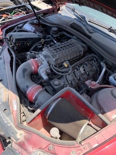

We know that the LS3 will fit but that supercharger sits pretty high and may require modifications to the hood. I dont really want to do that but will if needed. The other question is will there be room for the intercooler? I hope so.

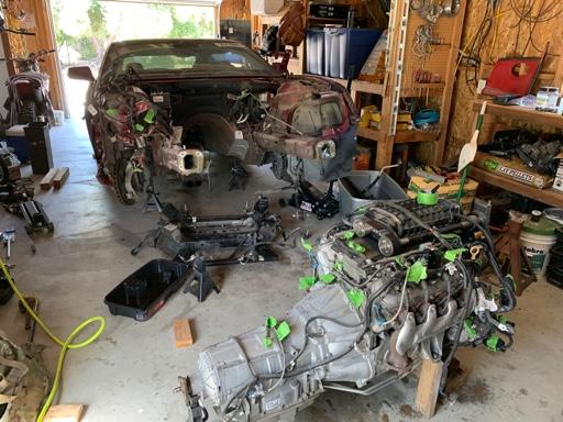

Making good progress today with the LS3 removal. The joker that owned the car before me installed some sort of exhaust flap system that would dump the exhaust right behind the catalytic converter. This made everything very tight and it is a wonder how he got it in there to begin with.

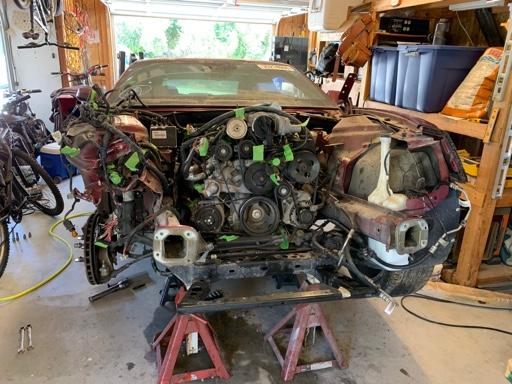

Some photos from today
Ready to pull:
Pulling: You can see Skruffy in the background. He is pumped!

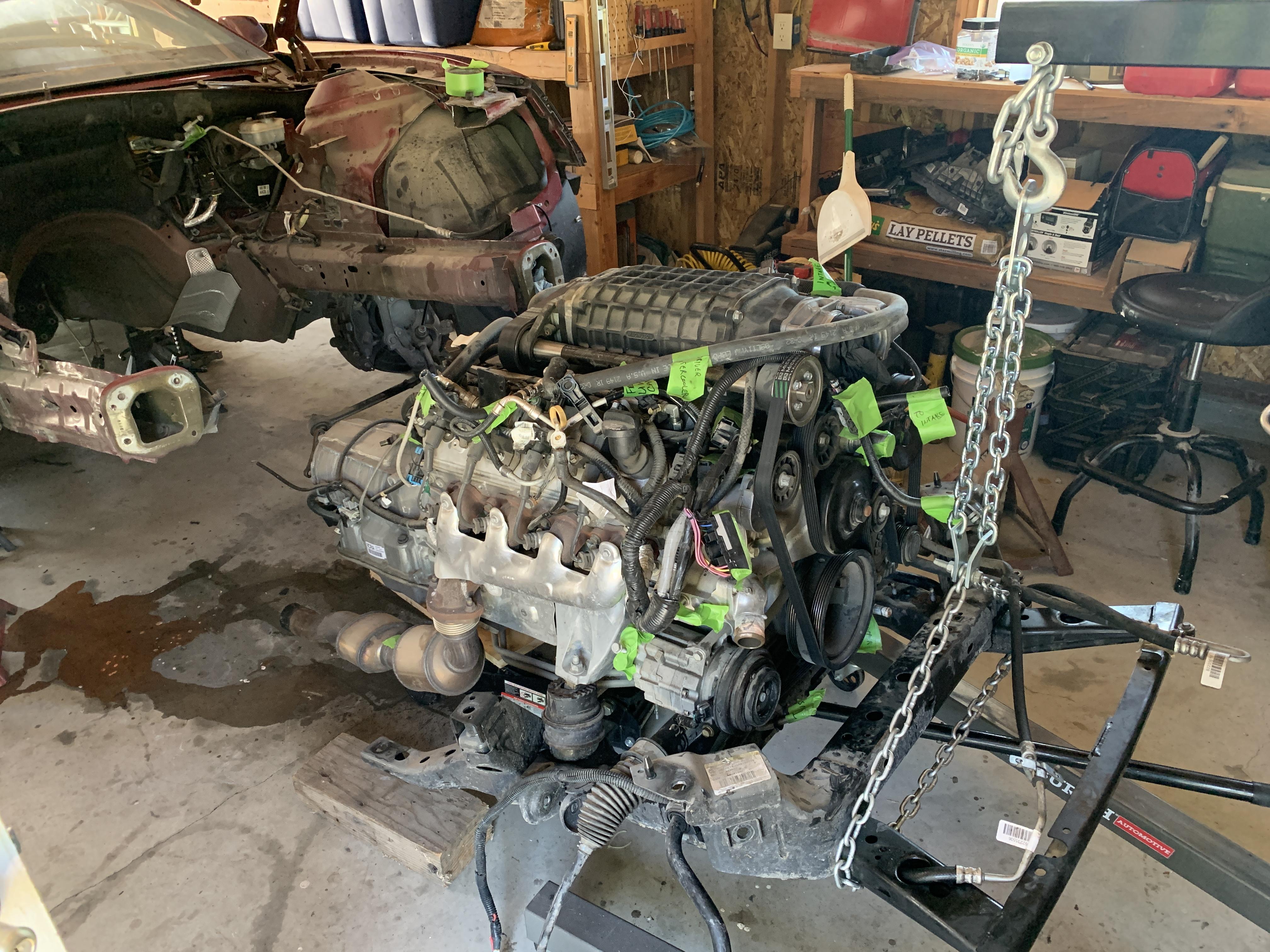

Pulled:

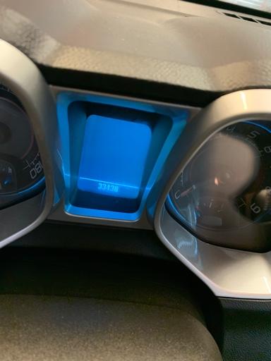

I got the car home and reconnected the battery cable that had been cut in the collison, and much to my delight saw 33k miles. Everything looked really good in there and I started it too. Fired right up.

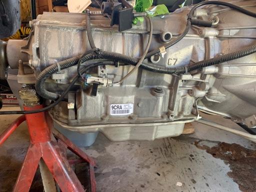

What trans is that?
