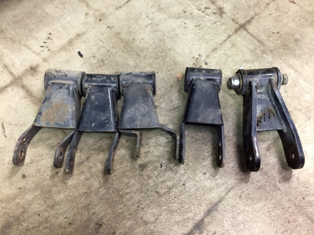

You could also run an adjustable shackle to more finely tune it...the shackles with the extra holes in them SHOULD be able to be adjusted down to where they are shorter than MJ shackles OR of course make them longer by using the right set of holes.
Beware of adjustable shackles
I've done the same to 2 sets of shackles LOL
I'll be going likely to a XJ shackle or maybe a JKS boomerang. Either way I gotta play with some leaves because 6.5"-7" lift on 33's is stupid. On a side note.. Was trolling the JY and I noticed also the 8.8 I pulled from the Explo had one main leaf and a bunch of leaves cut down to sorta a lift block size. The main seamed much thinner than the other ones like XLT v8 explorers. Just a thought.
