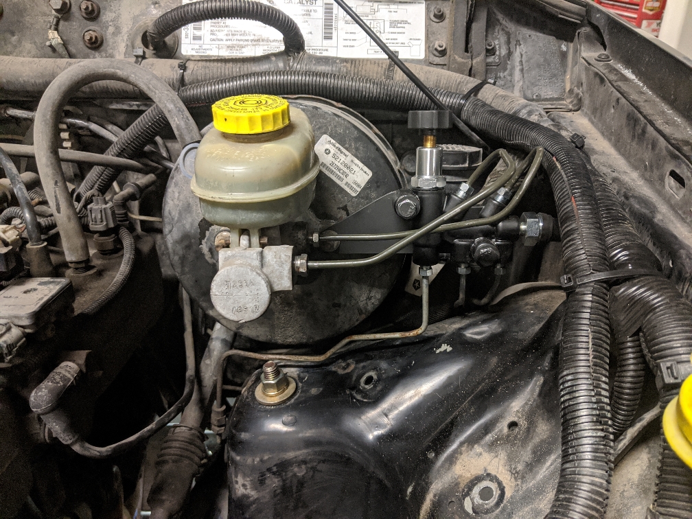

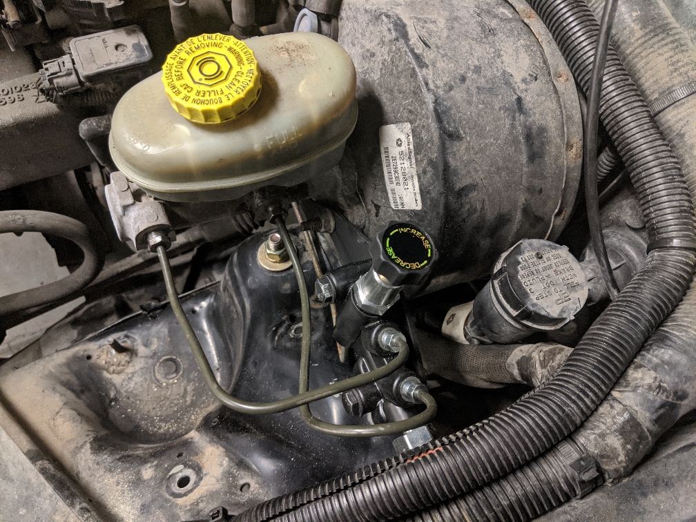

I removed the complete ABS on my 98. I used an adjustable proportioning valve from Summit Racing. The three hard lines on the chassis (front left and right and the rear line) I kept and needed to slightly tweak the shape to get them to line up with the ports on the valve body. I did make the mounting bracket to hold the prop valve to help make it easier to line up the chassis hard lines. If I remember I needed to change the nuts on the lines, so cut off the old flare, install the new nut, then redo the flare. It was tricky just in that there was not always allot of room to work with but I don't remember it being too bad.
The lines from the MC to the PV were made up using generic straight lines from the parts store. Again the only trick was making the flare, install the nut, then bend to shape and cut and flare the other side. The bends on the PV side are close to the nut so just needed to think it through and get a little creative with the order of putting it together.

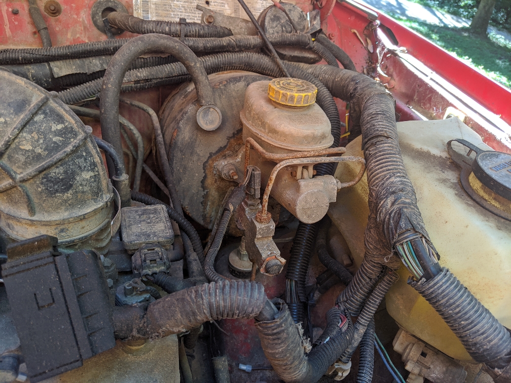

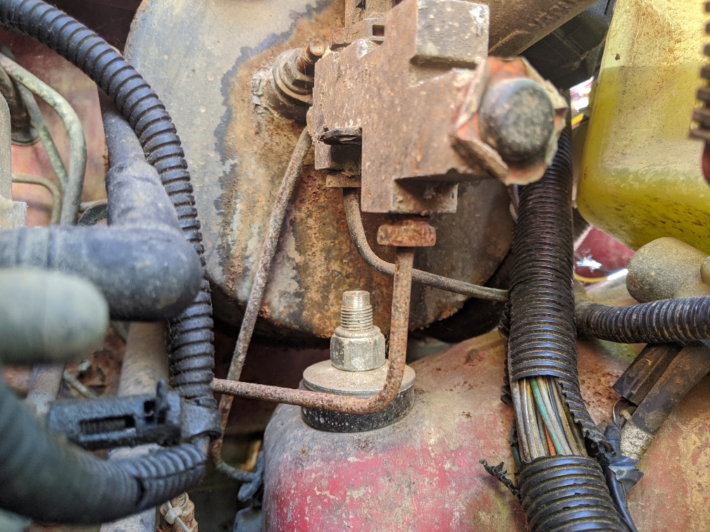

Why not use a stock PV that fits your year (non-abs) and go from there? Pick-n-pull is your friend in this case.
I think I had a non-abs parts Jeep at the time and may have swapped more than just lines but I'm honestly not sure... Regardless, here's what it looks like now.
Hard to get good pics since I relocated the washer bottle to where the ABS pump used to be.
Basically there's a left front, right front, and combined rear line coming out of the prop valve - just make sure that they get routed to the correct location after removing the abs module and you should be fine. Use hard lines with unions if necessary, I would not use soft line. I think I was able to bend two of the factory lines to fit and had to add a union to the other based on how mine currently looks.
I'm running a WJ front conversion and the rear is Ford 8.8 disks. That is part of why I wanted the extra adjustability of an aftermarket PV.
