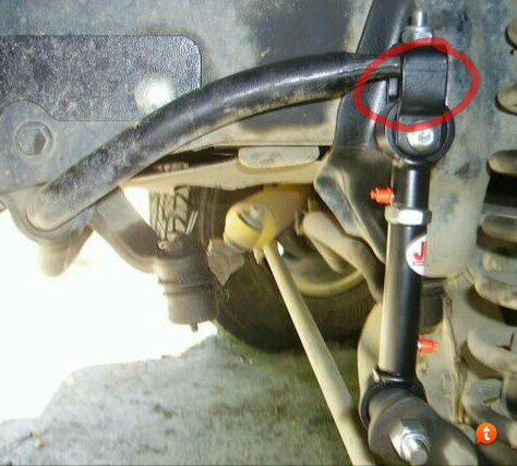

Yes back to me indeed as I have no mechanic paperwork whatsoever. Haha. I ordered the Daystar bushing set for anti-sway bars. Will I still need that if I get the jks. Is there no bushing needed for the circled area of my picture
I hope this image isn't too big. I'm using some android app called Tapatalk.
that pic right there shows you that even at your small lift, you need longer links. it is bending and will eventually mash the bushings until they fall out. the JKS unit has a bushing in the big round end on top, no need for a bushing or isolator directly on the end of the swaybar.
compare the angle of your swaybar to the one in the JKS pic. yours needs to be tipped up a bit with longer links.
Hmmmm I believe when I took this photo it was up on jack stands. I'll need to double check that as you make a good point. I haven't done any of the lifting yet. Still completely stock except one tire size up.

What you y'all think of these. A bit cheaper than the JKS. I do like the sound of how easy the JKS advertises easy connect and disconnect

I found the JKS locally for a pretty good price. I think I might rock those. You guys think the 0-1.5" will be OK for this set up, which is supposed to yield 1.75?

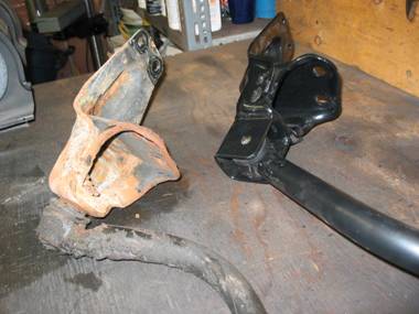

I bought a used RE 1600 from a local member. I did not like the frame side mounting system. Being cheap and handy, I did some welding on my stock bracket to work like the one on the right:
You can buy a manufactured set here: http://www.kevinsoffroad.com/cart/hardkor-track-bar-conversion-cures-death-wobble-p-1017/
Naturally, there are many other brands that will secure the frame end of the track bar in a similar manner.
