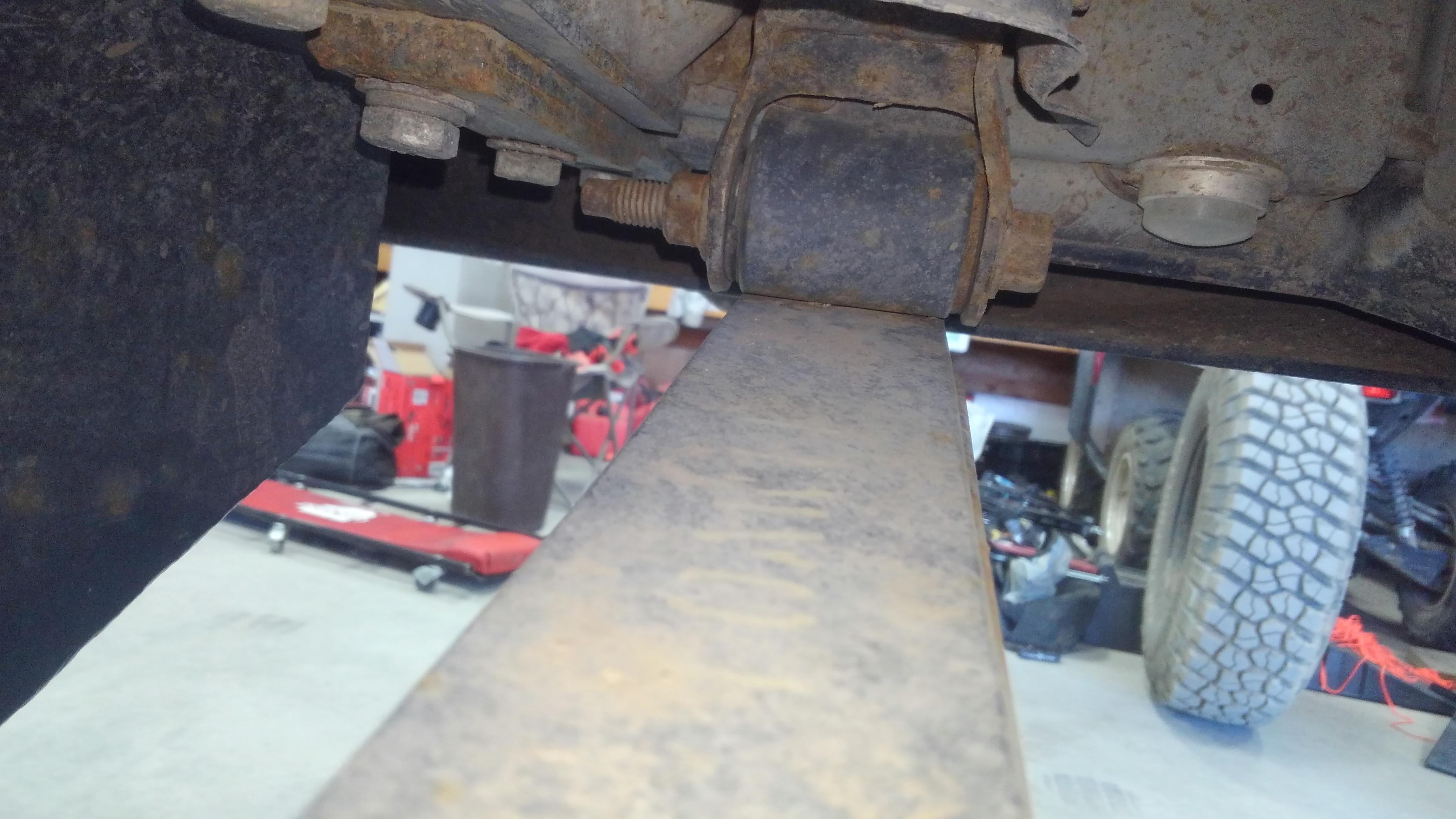

New stops, one where there was none. Felt good on the street, now to flex, see about bolt interference, and get it on the trail with my usual load.

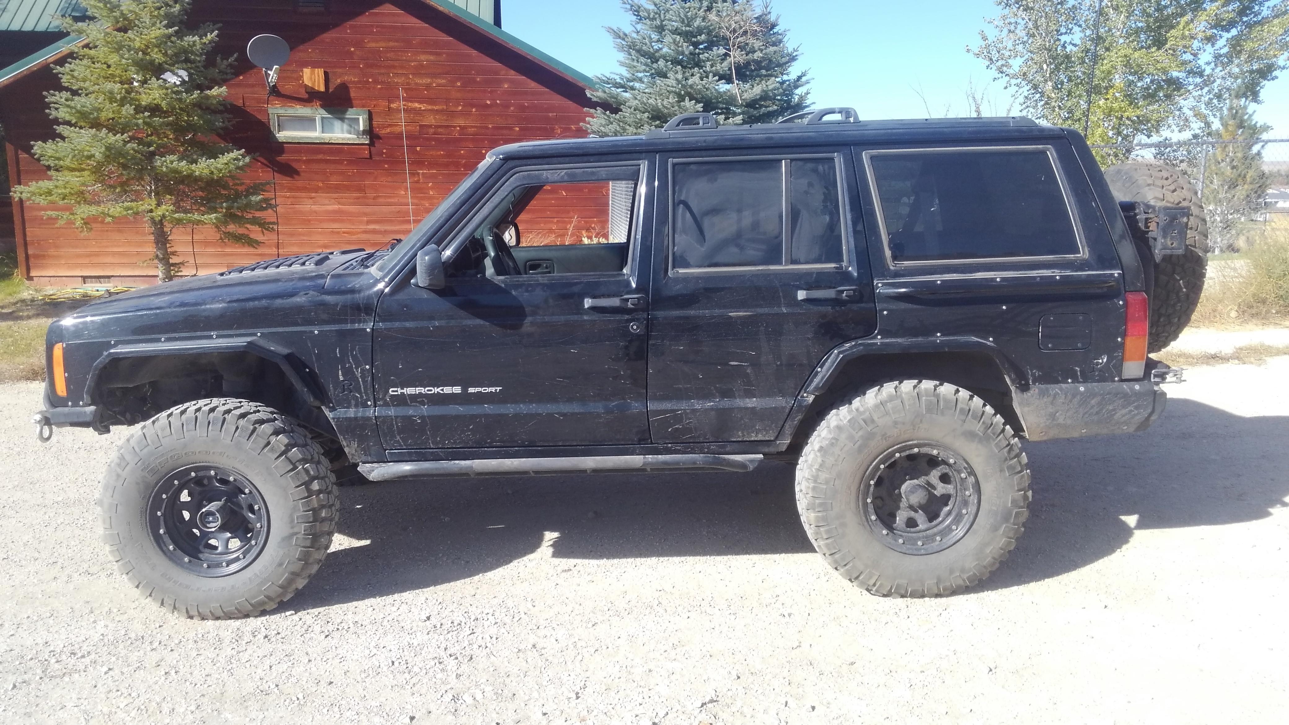

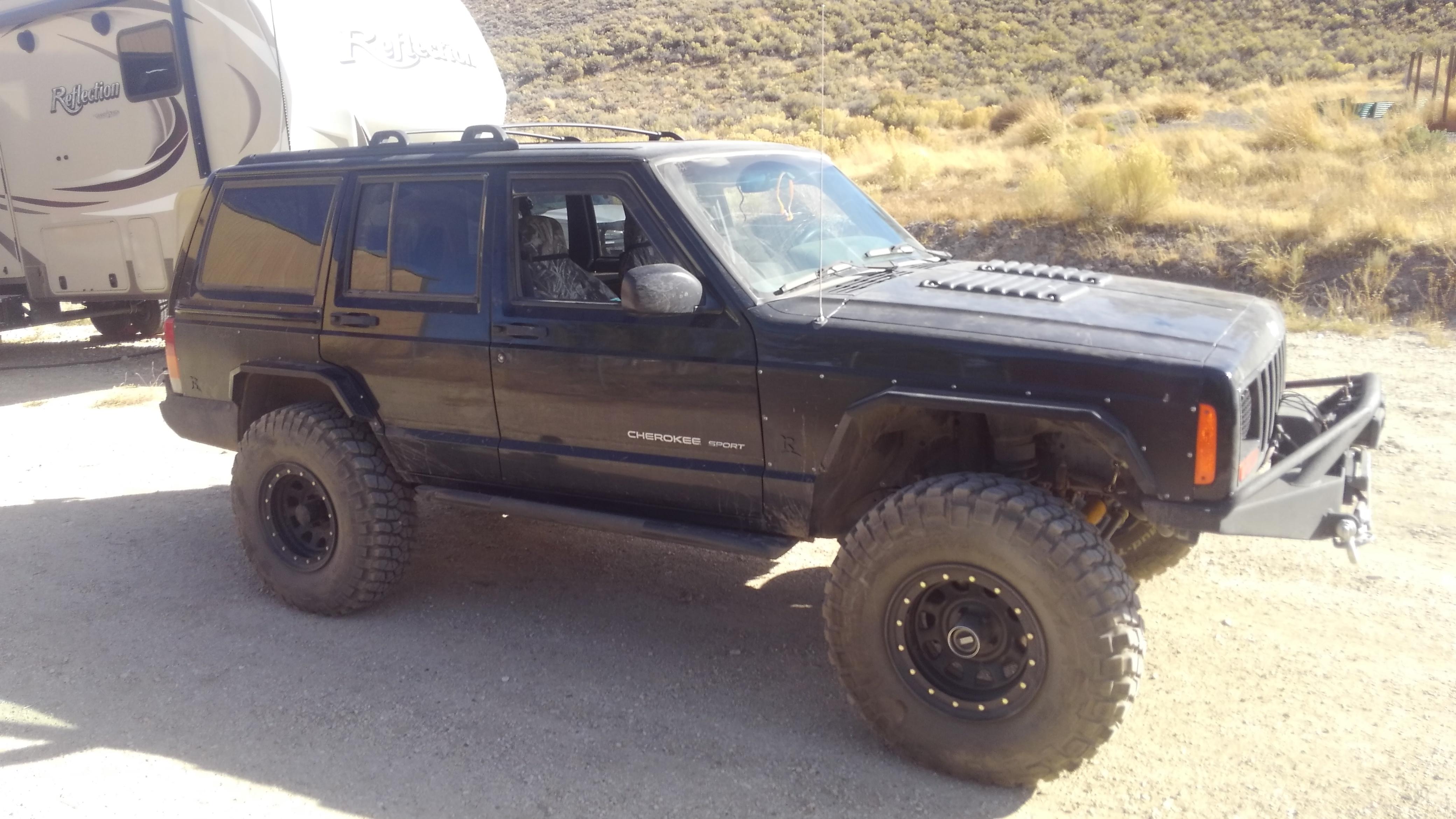

One more. Stance appearance is due to front fenders cutout more than rear I'd say.
Sent from my E6810 using Tapatalk
People think mines lifted like 6" due to front fender height.

What happened to the pic in the other thread and notice of the shackle mount being damaged? No concern?

I'm not clear on the damaged shackle mount. I haven't removed any pics and don't even know which one was referenced. Also have noticed nothing indicating a damaged mount. Maybe more pictures are in order (but hopefully not of the HUGE variety in this thread.

Hmm.. I'll look again but need a 'good' one to compare. Maybe another pic from the side will help?

A side pic might help. The shackle box outboard wall flares open towards the back of the box, but its parallel to the unibody rail starting from the bolt hole and going to the front of the box. Yours looks pretty taco'ed, but it could be he photo angle and fish-eye exposure.
I see it making a Z shape... so that'd be a hellova fish eye!
Ok, shackle box is fine. But I'm finding marks on frame, body each side. Longer or boomerang shackle the fix?
