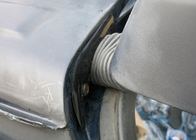

Absolutely love the idea, cheap, easy, and very useful. my question is, where is everyone running their wiring!? i mounted my cb antenna on the hatch and it was a pita to try to hide the cable.
I pulled the stock wiring bundle, enlarged the holes in the hatch and body, and then used a rubber bootie from a door to give me a larger wiring channel.
I had to replace the connectors on the hatch end of the harness since they were too big to pull through, however I have a lot of room for any desired mods now
