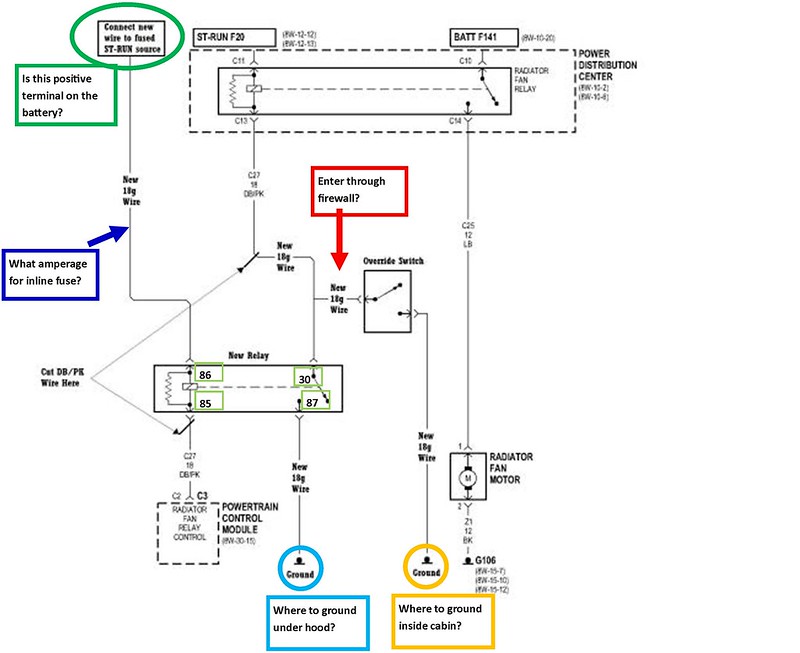

fyrfytr - Let me just start by saying I really appreciate all of the help you have given us late model XJ guys by figuring out how to run the aux fan override without throwing a CEL. I think the design change Jeep made for 2000 and 2001 XJ models to do away with the AC on triggered aux fan, and stick solely to a computer based reading of AC system charge or engine temp was dumb. I have redone the following in my 2000 XJ myself: new radiator single core, coolant system flush with 50/50 Zerex G05 - distilled water mix, new e-fan, and still with the AC on in traffic on a hot day it is constantly hitting the 217* limiter that kicks on the aux fan on. When rolling in stop and go traffic on a hot day, I would rather just be able to kick the aux fan on manually until I am off and moving again. This likely would also help the AC stay cooler - on 95* days my AC just can't get cold, more like a mildly cold breeze.
That leads me to my questions about your diagram. I am shade tree mechanic and my electrical expertise is limited. Can you take a look at my below updates to your chart and let me know if I have labeled everything correctly, particularly the new relay numbers? Really appreciate the help.
Close but not quite:
1. Your "New Relay" numbers are correct.
2. The ST-RUN source in your green box is NOT the battery. It is a fused 12V+ source that is only hot when the key is in the Start or Run position. I detail where to find this DB/WT wire in the original post. It can be found elsewhere, that was just a convenient location for my relay placement.
3. See #2 regarding your dark blue box. You are using a fused 12V+ source so an in-line fuse is not necessary. If putting one in would make you feel better, you could probably use the smallest one you could find. A relay coil uses almost no amperage. Not necessary though.
4. Engine compartment ground in your light blue box goes anywhere that is convenient. Lots of options to choose from, I think I used a ring terminal on an existing grounding screw near the air box. You could also tap an existing ground wire somewhere in the harness, or you could even ground to the battery if you really wanted.
5. If you mount the override switch in the cabin and the new relay is in the engine compartment, then yes, the ground wire passes through the firewall as indicated in your red box. There's a spot in the driver's footwell that I like to use.
6. Grounding inside the cabin has lots of options as well. Again you could find an existing grounding screw and use a ring terminal. I tapped a ground wire in the overhead console as that's where my switch is mounted. There are also ground wires to be tapped in the center console and the dash depending on where you mount your switch. Dash lighting circuits are usually pretty easy to find and safe to tap into for this use.
fyrfyt: first of all thanks a ton for this writeup. I've been studying it and learning a lot. Last night I put my relay in (NAPA Bosch-type 5 pin) and simple toggle to my dash. I haven't tested to see if the PCM will turn on the fan at 218 with the switch OFF yet, but the fan does not come on automatically when my A/C is flipped on. (1998 XJ) I've been studying more to figure out where I went wrong.
In your writeup, this is the pinout specified for the relay:
Relay Pin 85 - DB/PK wire coming from your PCM
Relay Pin 86 - DB/WT (ST-RUN) wire
Relay Pin 30 - Ground wire
Relay Pin 87 - DB/PK wire going to the Fan Motor Relay (in the PDC) and the ground signal wire coming from your override switch
Relay Pin 87a - May or may not exist on your relay, but is unused regardless
BUT...per beasticles' diagram, Pin 30 and 87 are actually switched around. You confirmed this is correct. Is this mixed up in your original post? Perhaps all I need to do is switch those around? I currently have the DB/PK wire + switch ground spliced to 87. The fan does switch on and no CEL when I do turn the switch to ON.
