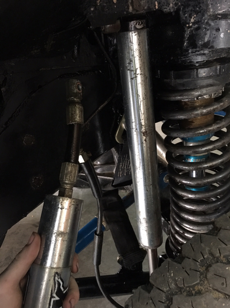

Was screwing around at the shop and ended up somehow killing a 90 degree fitting on the front passenger shock. Now to figure out why exactly it went. Not sure if the reservoir came loose or the shock crashed into the fender.

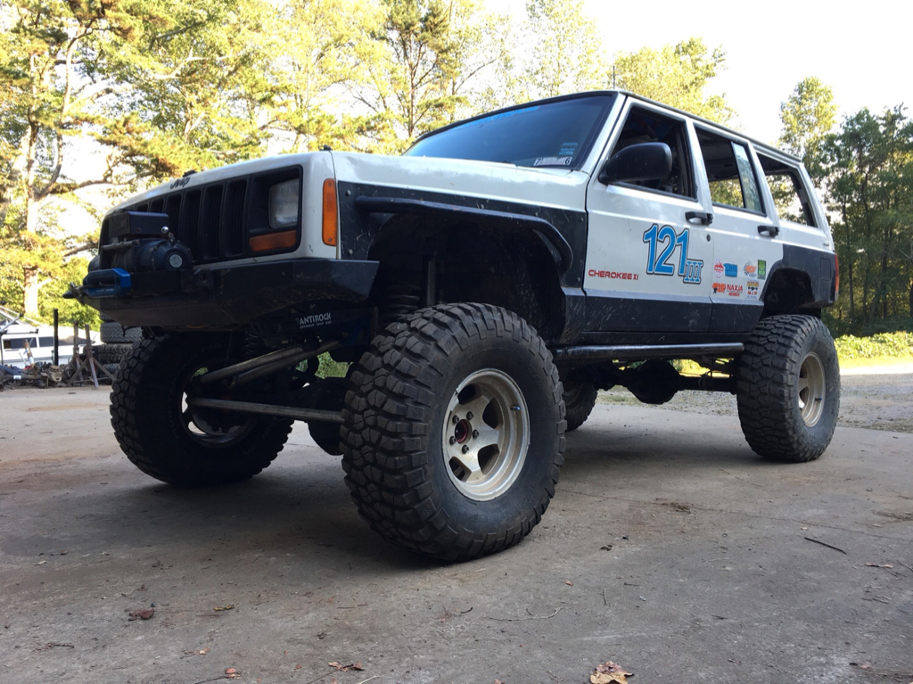

Circle the wagons, looks like my little race wish came true. CHeRoKeE Short course race October 27th at Dirty Turtle Offroad Park. Time to start dialing her and get some practice laps in. I might end up over-prepared lol.
