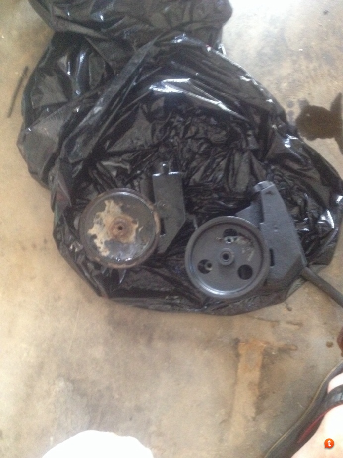

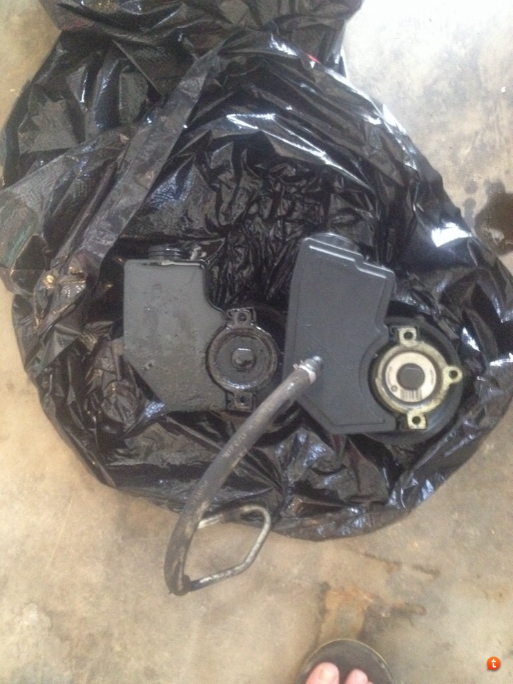

i compared the old one with the 2001 pump i had. Turns out the 2001 and other ho pumps have a way bigger reservoir.

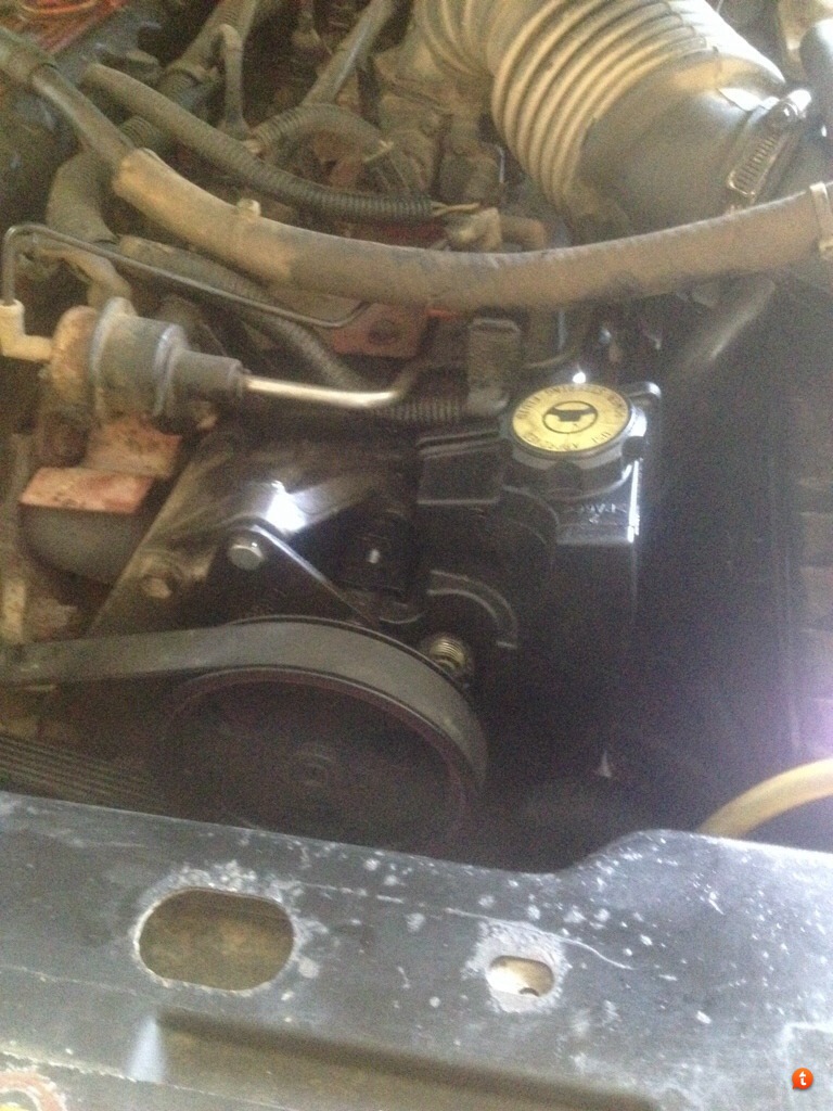

Decided i must have it, took 2$ worth of fasteners from ace and it bolted up. The high pressure line needed some massaging to clear the new reservoir but the stock line can still be used

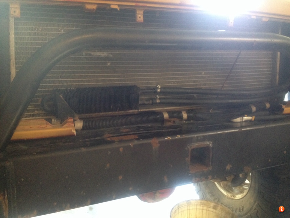

Added a cooler that was laying around
It steers like a new jeep, no more angry sounds or sp
