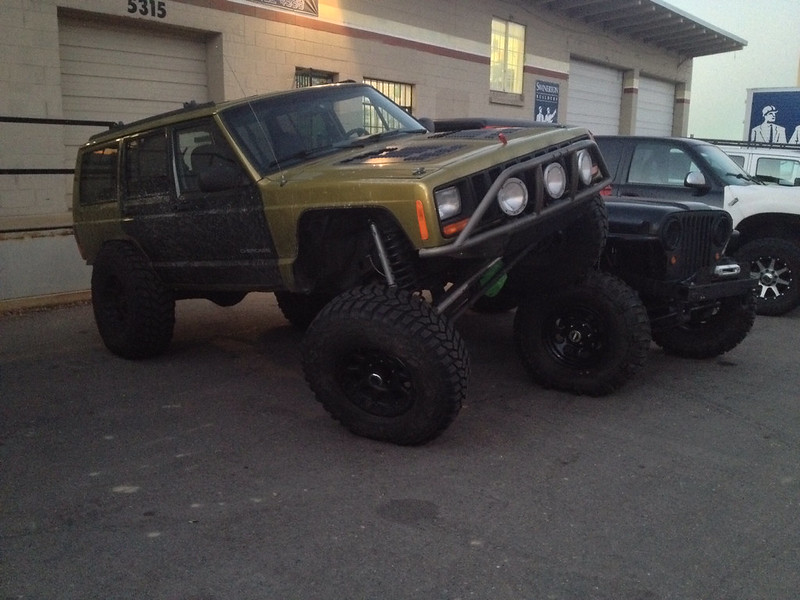

Bringing my jeep and this thread back from the dead! After getting my jeep back and contemplating dropping it down and putting it back on 33s I made the right decision and kept building it. I threw a set of 37" maxxis trepadors on that i got this last summer at truckfest and then lowered the jeep a little, down to around 4.5" of lift. I made a custom pack of mj/xj leafs that are military wrap, so they should last longer then my last few packs. I threw a crane knuckle and highsteer arm on my 44 and built a 7075 drag link. I bought a shittybilt winch and built myself a tube bumper, welded on some hooligan boatsides, and thats how the jeep has been for the rest of the summer and all winter.

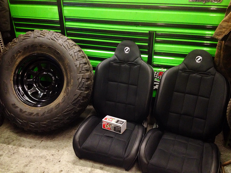

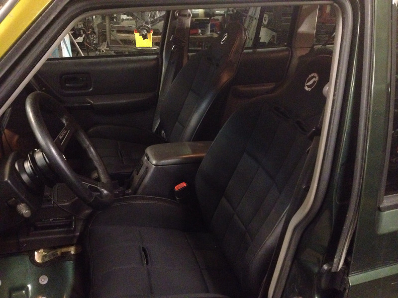

Now ive got the serious itch to build my jeep for mod trail class and do some dirt riot racing this summer. Two days after getting back from the hammers i ordered up 65 feet of 1 3/4" dom tubing and a 20 foot stick of 1 1/2. I picked up a steel wheel to mount my spare, and bought a pair of corbeau baja rs seats and got to tearing into the jeep a little.
image by proracedriver616, on Flickr

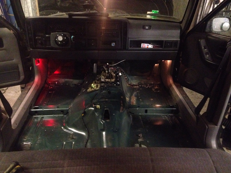

Out came the headliner and carpet to start cagework, and in went the new seats

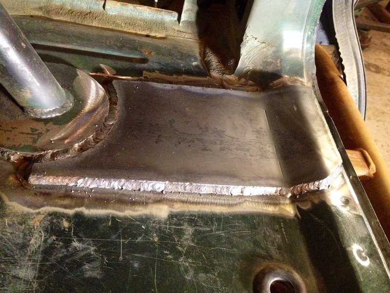

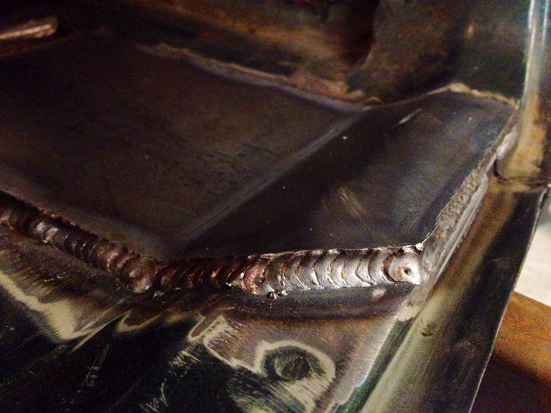

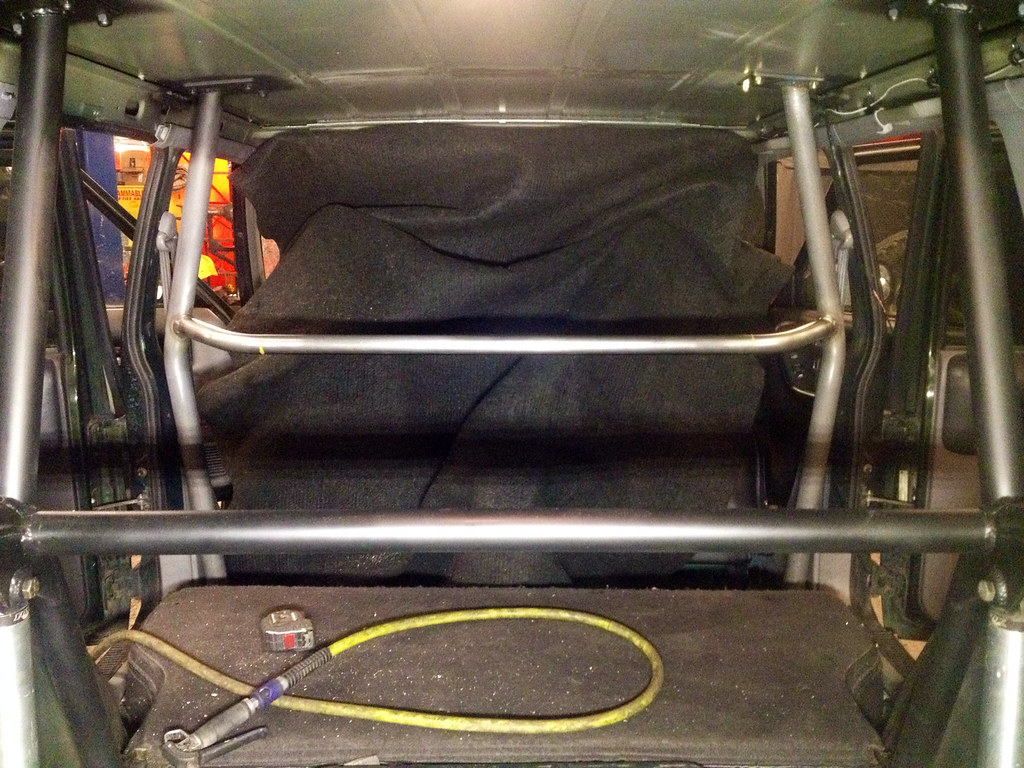

Got a little more progress made on the jeep, i made floor plates for the D pillar bars and got them both welded in behind my existing plates for the shock hoops. I got both D pillar bars fitted and welded in, along with the sandwich plates on the roof.
I will be building internal B, C, and D pillars and doing external A pillar bars that go throught the fenders and back along the drip raills. All of the internal cage will be tied into plates sandwiching the roof and then tied into cross bars on the outside of the roof. Basically im building a "hybrid" cage as most people call them, its necessary for me to build this type of cage to have some headroom, expecially when wearing a helmet.

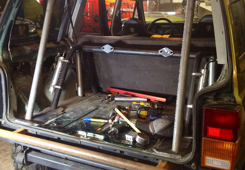

Out came the shock hoops.....
.....and in went more tube....
....then i made new upper shock mounts and laminated them....
Got both sides done and the shocks recharged and remounted, now the shocks will be tied into the cage and the cargo area looks a little cleaner. I made the "hoop" a little taller to fine tune my shock travel. The shocks also moved back to the furthest mounting hole on my u bolt plate and i was able to inboard them a little, so although the holes in the inner fenders are actually bigger, i will be able to make bolt in cover plates that fit the shock a lot tighter and have less of a gap then before.

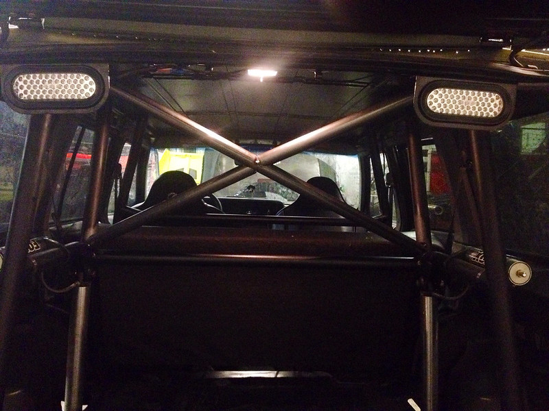

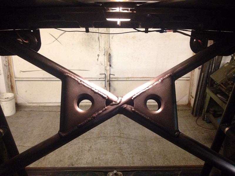

I apologize for it being kinda dark in a lot of these pics, but i am doing all of this work at night after work. Once things are a little further along ill take some good pics during daylight.

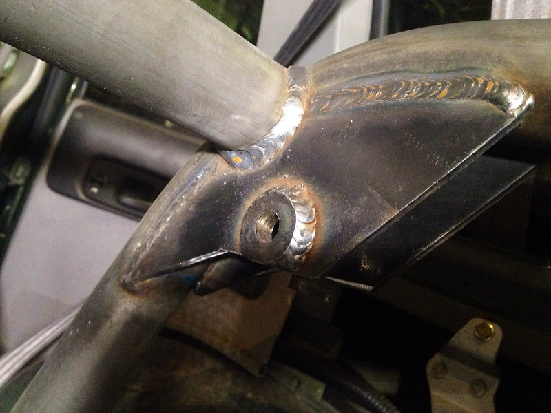

I got the my x brace all fitted and welded, kinda hard to tell in the pics but the x brace runs diagonally between the bottom of the C and top of the D pillars. The lights in the back are; an amber dust/follow light, and blue limited class strobe. I didn't technically "have" to install these, but if you have ever been out to hammers or really any offroad race you can attest to how dusty it gets and these will give me a little more visibility from behind.

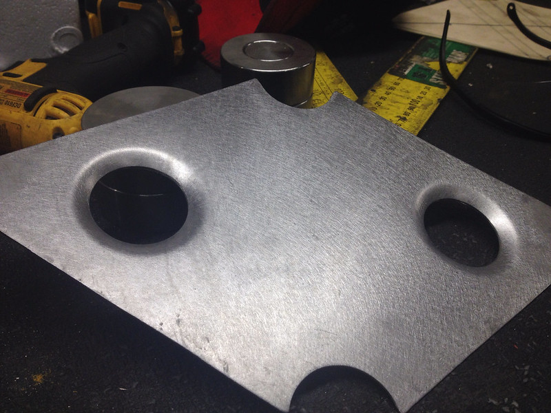

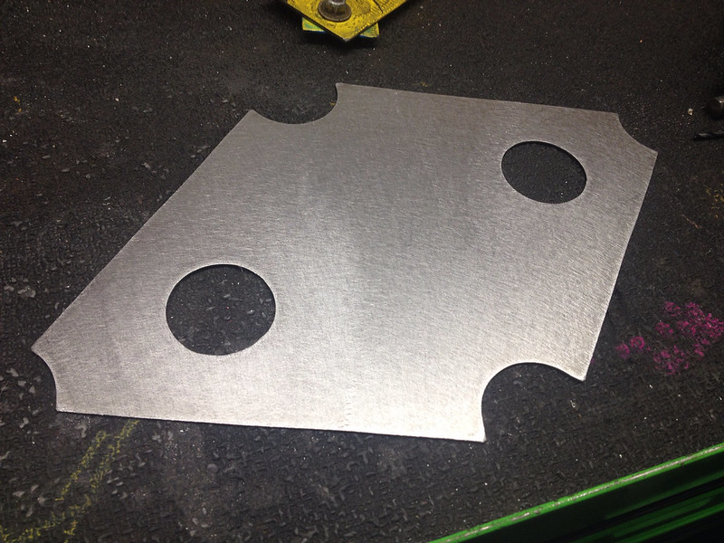

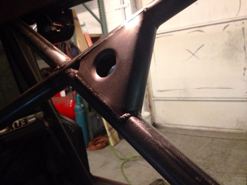

I want to start getting away from doing the basic fabrication that everyone does on rock crawlers, i feel that rock crawling is in the stone-age compared to a lot of other forms of motorsports. I have always been a fan of rally racing and decided that i wanted to make FIA style saddle gussets on my cage. They were a little more time consuming then simple tube gussets, but they are a lot lighter, and look way cooler. I feel they are just as strong if not stronger due to the fact that they are 3 dimensional in shape and in the fact that they are dimple died, also there is a large weld area on them.
Re: where have all the good cherokees fs gone
That's sweet. You should just make and sell those gussets.

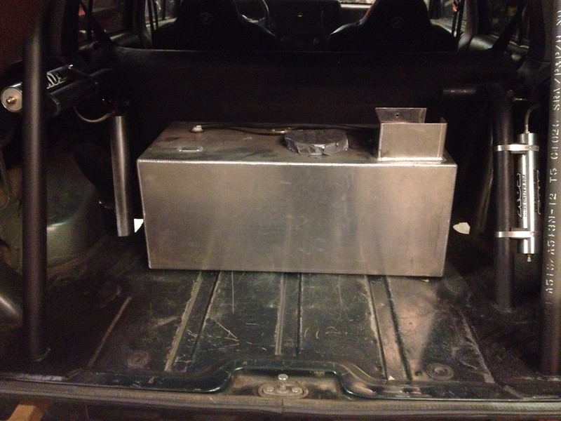

Thanks dutch, I would love to add more bars to the interior part of the cage, tying the c and b pillars together, adding door bars etc. I dont think i will add a ton more though as this is my daily driver and i have to keep it somewhat practical for my girlfriend and daughter to ride in there with me. I wanna keep it easy to get in an out of and also safe to ride in on the street by minimizing the change of hitting your head on bars.
I had the spare in the other night with the cell mocked in place, ill think ill tilt the front of the tire up and have the back stick through the hatch, trimming as little of the hatch as possible. I really like the loosenuts rig, thats a big inspiration for how i wanna do my tire.
You can get them through cagethis.com and a few other sites, but they are pretty expensive. It was fun making my own, but i dont think it would be worth my time to make them for resale. Plus every single one is different based on the angle of the intersecting tubes
