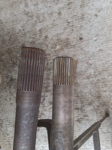

I spent the afternoon at crawlertech today and made a little headway on getting my jeep going again. I pulled the 14 bolt axle dubbed "tin man" from the pallet rack and started tearing it down. That axle has been on the verge of being built by numerous people at crawlertech sinch josh got it...and i spray painted it "chrome" as a joke when jon aursland was gonna build it for his yj, and it got the nickname tin man lol.
I got all the brackets and tabs cut off, sanded the tubes smooth, welded the tubes to the center section, and started bolting on the disc brakes.
All thats left to do is clean the center section a little more, weld the perches on, and run the brake lines on the axle, then itll be ready to bolt in! Gears and a locker will go in after i sell the 9" to help cover some of the cost.
Oh, and heres a comparison of my 9" shaft next to a 14 bolt shaft
