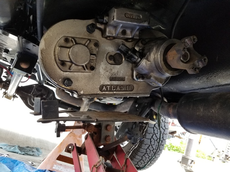

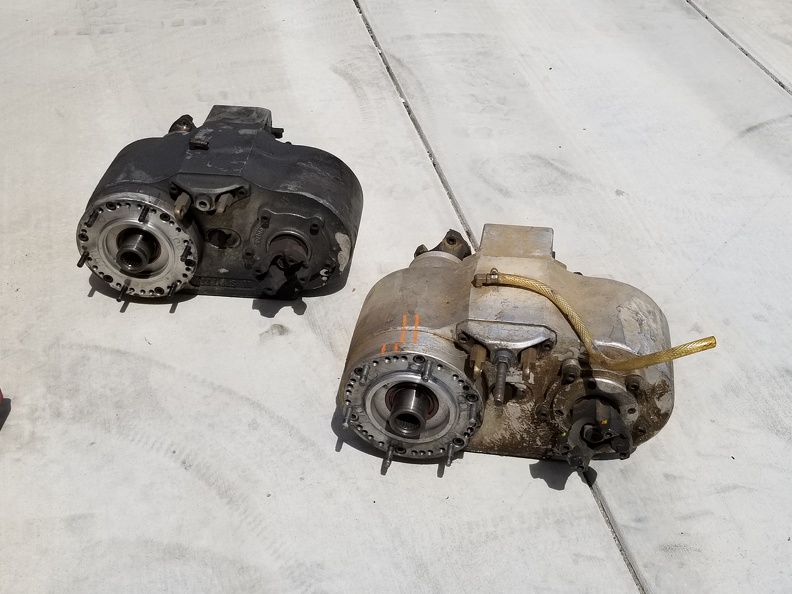

Slow weekend, but I swapped the very old atlas (serial 0068) out for the MUCH newer one off of 4643 which has a fresh rebuild on it.
Its funny, I've never used the trans jack for a trans, but it makes an atlas swap really really easy.
Now on to working out shifter stuff.
