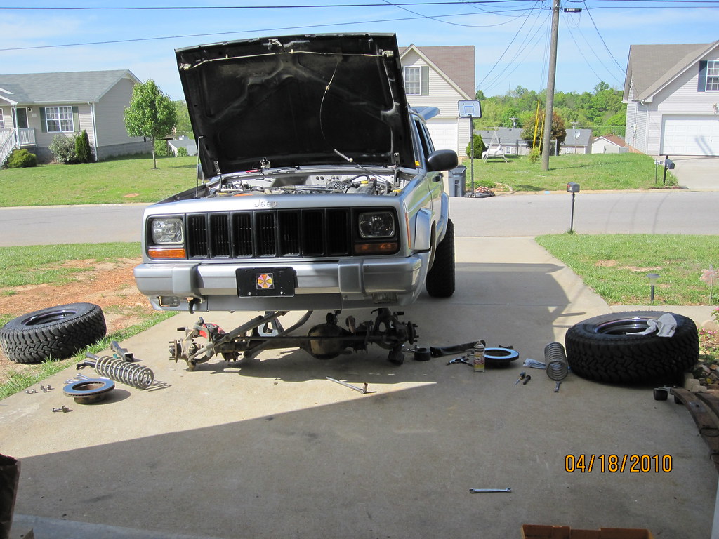

Going up !
LAZR gained another 2" on sunday, it now sits at about 5" total lift. Spent the afternoon installing the drop brackets, coil spacers, adjustable track bar, extended shackles.
