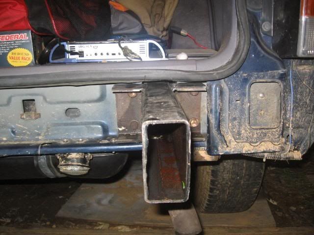

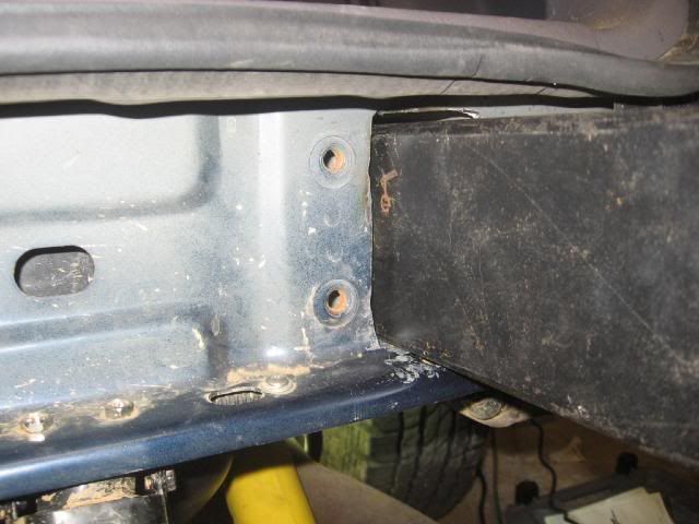

here is what i would like to build, but im not sure if time will allow. spring break sounds reasonable, but the girlfriend wants to go do other things.
first off... the frame rail sleeve that we all know:

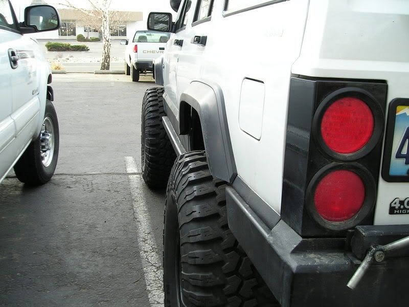

second, i want to recess the swing arm into the bumper:
http://i1143.photobucket.com/albums/n621/COLEgasmaxx/jeep forum/102_0414.jpg
and i want a swing out/down carrier like this:

add some corner protection, make the lights flow, and brace it:
http://i99.photobucket.com/albums/l318/jdbwrx/P1010523.jpg
http://img.photobucket.com/albums/v246/VET8911/P1010169-1.jpg
you get the idea. biggest goal is to get the tire higher up. also, make provisions for jerry cans, highlift, and the license plate. 8 stock bolts, 8 from the nutstrips, and 2 in each side into the frame. 20 total... should be strong enough to tow and lose the hitch, not DOT approved, but strong enough. stronger than the jeep at least.
