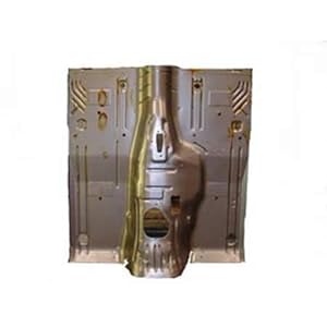

Anyone ever stumbled across a one-piece floor pan for an MJ? Also, I think I've decided to keep my eyes peeled for an XJ firewall so that I can knock out all the body work at once before I get into my donor XJ.

Floor Pans from C2CFabrication.com
The good news is that the only rust I have to repair will be hidden under some POR15, some rubberized undercoating, a layer of Dynamat, carpet and heavy floor mats.
Those C2C floor pans are nothing more than XJ floor pans. The guy I have doing the body work on my truck was very disappointed in them. You would probably be money and time ahead to cut the floors out of a donor XJ. You could even get it out in one piece (rocker to rocker) if you took the time. I wish I had done this.

Thats what I'm noticing in the pictures. I even found OEM Chrysler rocker to rocker floor pans for the XJ that include the tunnel for $230.. But MJ and XJ are different from under the seats back.

If you look back at my MJ picks, my floor gradually slopes up on the frame channels towards the bed.
May have to buy that floor pan and modify it to fit the MJ. I'm guessing all MJ floor pans are custom if they are replaced anyways.
I would be tempted to leave the top portion of my frame rail off, cap tge rail from underneath the floor pan with 1/8" and put the xj pan on top. Then I can use my xj seat brackets without modification (notching them out) and have a flat floor pan for xj carpet.
If I'm thinking right, there would then be a gap between the frame rail and the pan under the seats... Not sure that would be an issue though.

This is close to the direction I would go, but I would re-install the frame rail cap. Take your time removing them and buy lots of spot weld removers from HF. The necessity of the frame caps is really unknown, but I was inclined to keep them since I plan on using the truck, as a truck.
If I was doing it for a 3rd time, I would cut out the floor pan out of a donor XJ, rocker to rock and mid-firewall to just past the seat brackets. Since MJ rot seems starts at the firewall/floor pan seam, a few inches of firewall usually needs replaced anyhow. The firewall and front part of the tunnel are the same shape between MJ and XJ. You will need to massage the XJ tunnel to fit the MJ floor at the back, but this could be done so that it is under the console or under a bench seat. Then patch the inevitable holes formed under the blobs of seam sealer in the back corners of the cab.
