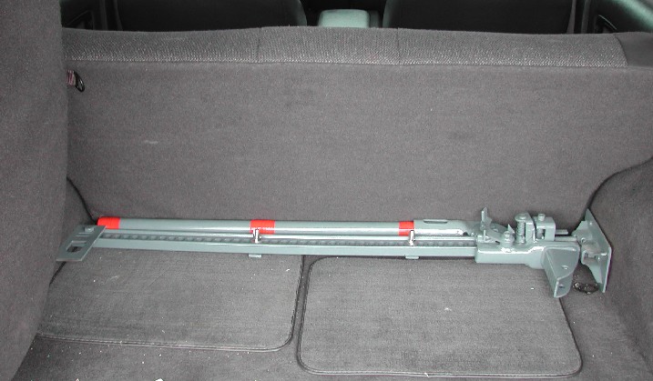

Nothing fancy going on in my cargo area. I have a shortened hi lift on the floor. It's tied to the passenger seat belt bolts with 1/8" steel. I keep my tow strap inside the rear tire. I use a plastic flower pot base to keep it secure. The factory spare carpet covers it up. I'd like to build a rear cargo rack as well, just need to find the time to do it.
