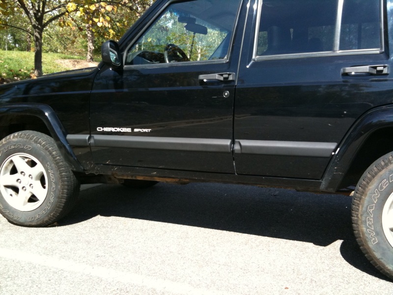

When I bought my XJ it had a fresh coat of wax and the trim was black. The previous owner said he'd used petroleum jelly to get the trim dark. After a couple washes, it was back to gray. Earlier this week I bought a couple cans of Krylon Fusion. I had used a different kind of plastic paint when I painted my ATV helmet a few months ago with mediocre results. The Krylon stuff is a lot better but I'm still not impressed with plastic paint. With the right prep and good paint, I've had good results on a variety of surfaces with standard spray paint. I don't think I'll ever bother with plastic paint again.
The Fusion can said to clean the surfaces to be painted with an ammonia-based cleaner.
The left hand piece I had tried to darken with a heat gun. It worked, but the color is inconsistent.
I taped as tight behind the trim pieces as I could to prevent overspray from getting behind them. I didn't want it on the body should I ever decide to just remove the trim pieces. I debated doing that this time but decided to leave them for protection from other doors in parking lots.
After doing the first side this way, I realized it was overkill. On the other side I just used two runs of tape.
The first coat.
Two good coats seemed to do well.
It took one can to do two coats on both sides and the rear corners.
If I had it to do over again, I think I'd use flat instead of satin. Other than that, I'm really happy with how everything turned out.

Thats the way to go, I did the same deal... After about 2 years I've just now started to notice some areas that need touch up. It never flaked off, I just have some tree / brush rub areas that scraped some spots. KRYLON FUSION FOR THE FRIGGIN WIN.

Patience and diligence are apparently virtues... I found flat black at Jo-Ann Fabrics and got the driver side done yesterday (sorry, was too dumb to take a "before" pic):
This is approximately 18 hours after painting. I think flat black actually looks fantastic, can't wait to do the rest of the trim.
What did you paint in this pic? those fender flares are not flat black. and the plastic trim looks grey
Yeah it does look kinda gray. I am debating using the Krylon Fusion to do the same thing but I can't decide whether I should use the flat black or the satin. The satin is too shiny for my taste but the flat black looks more gray than black. Has anybody had any experience with the Krylon Camouflage? I saw it at the Checker by my house and it comes in "Ultra-Flat" black.
